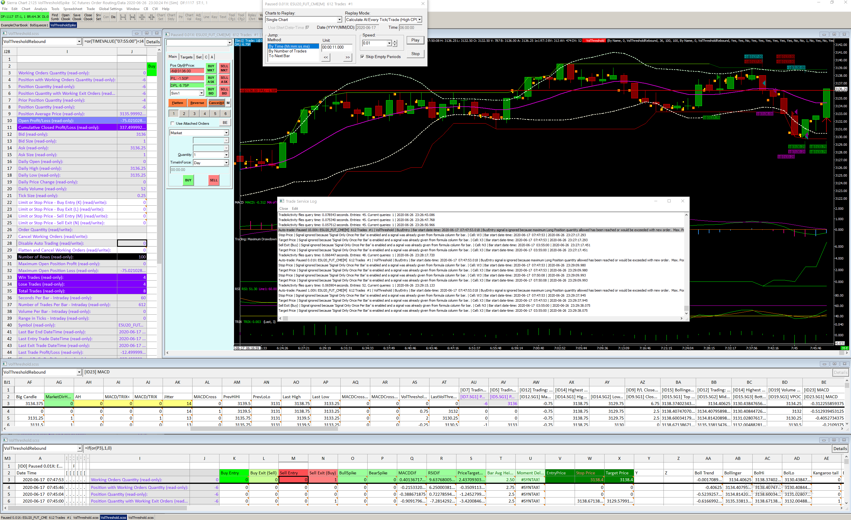

The new version (just installed today) seems to have a major bug with the replay. Here's an example where I have replayed and stepped through the timeline at 0.01 speed and captured a frame where it's showing -6 short but M3 is empty and there's no code to go short here. https://share.getcloudapp.com/9ZujDjpx
In fact I'm getting lots of problems of these two kinds: a) replay issues where it adds new ficticious trades when using the Jump back feature, and b) reversals where there shouldn't be and exits when there shouldn't be.
This latest version 2125 is unusable and I have wasted my entire day trying to figure out why. I'm giving up. Is this a known issue? Shall I just revert to the previous version?

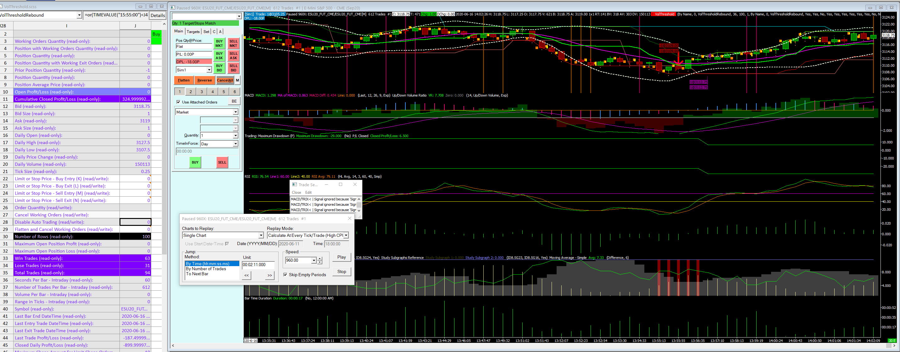

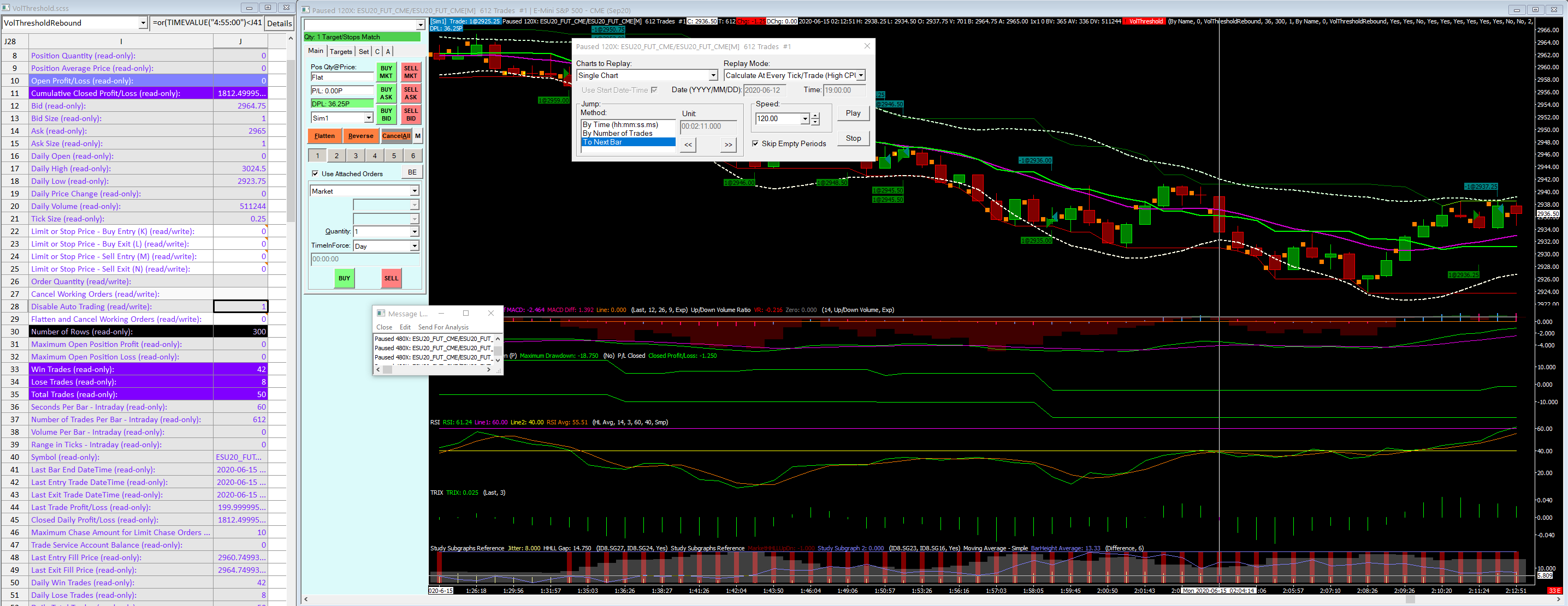

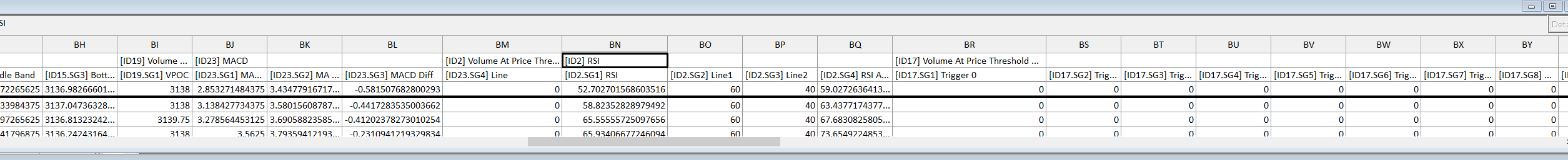

Another bug that may be causing the rest of them: the studies keep jumping around between when the replay is paused or playing. Check out these screenshots of the exact same spreadsheet but one is paused and the other is played.
imageImage 2020-06-27 at 12.46.30 AM.png / V - Attached On 2020-06-27 04:51:07 UTC - Size: 21.79 KB - 493 views
imageImage 2020-06-27 at 12.45.37 AM.png / V - Attached On 2020-06-27 04:51:18 UTC - Size: 30.57 KB - 431 views
[2020-06-27 05:29:58]
Sawtooth - Posts: 4361
Some thoughts:
- You are replaying two separate charts of the same symbol, each with their own entry rules.
- The Chart Data Output Sheet Number settings on two charts is causing a conflict.
- You are using the same-named spreadsheet concurrently in two chartbooks.
IOW, it's probably not a bug, but rather some issue with settings or the setup.
I've been using v2125 in replay all day without issue.

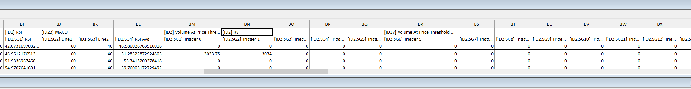

Here's another issue I encountered today. I'm replaying and everything is working fine. Suddenly it stops using the attached orders without me having done anything. I had to stop and back up a bit to get this screenshot, but you can see the attached orders are not there, whereas the previous 22 orders all worked perfectly. https://share.getcloudapp.com/JruLGp68

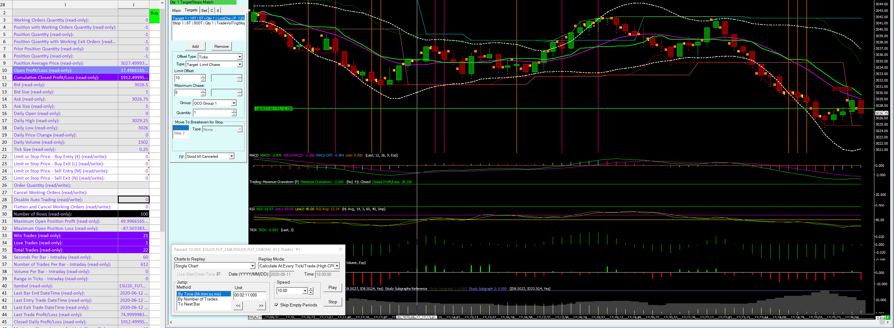

Another good one for you. Here it traded 2 instead of 1 during a new replay (not using jump). It has been trading 1 all previous 94 trades, and then suddenly trades 2. https://share.getcloudapp.com/jkuQmRZ1

Regarding post #10, you need to start the replay again. Use a different trading account if you want to preserve the existing trade activity.
Regarding post #11 and #12, refer to:
Automated Trading Management: Troubleshooting Automated Trading System Behavior
Regarding post #13, there could not be possibly anything wrong. We are not understanding what you are trying to show and this would be a chargeable support request as this would take an in-depth examination and going through this with your files.
