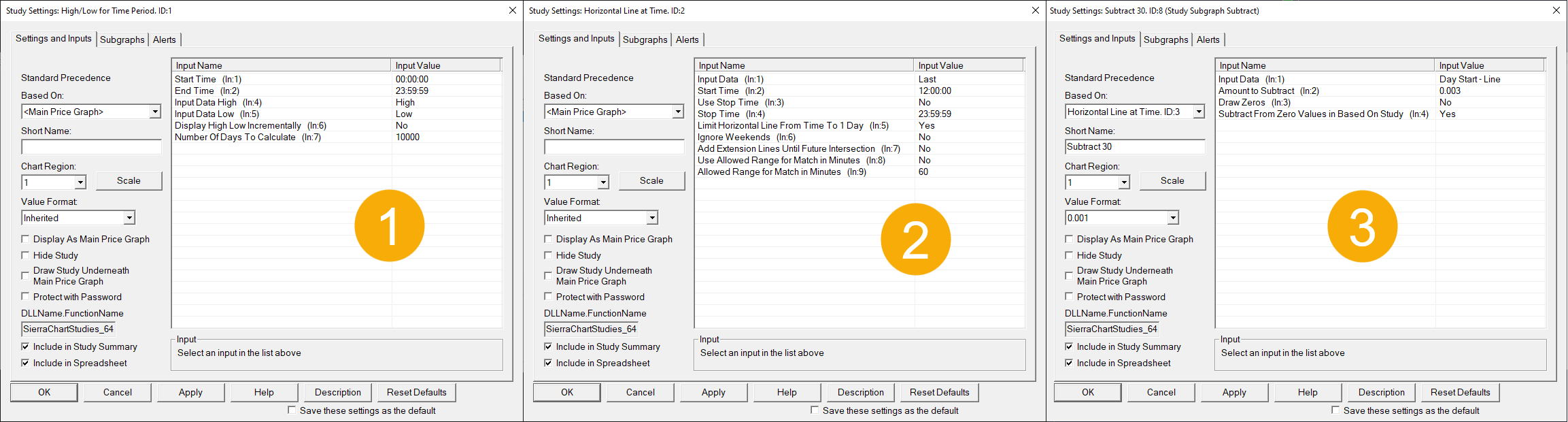

grantx - Posts: 244
The problem is that I am using the 'horizontal line at time' as a reference for other studies which are above and below. So if that high/low for time period study had a midpoint reference to work with that would be awesome...
[2020-06-19 17:40:19]
Ackin - Posts: 1865
There are several types of settings / views in that study ... send the screen here as you set it up
[2020-06-19 18:21:54]
grantx - Posts: 244
Look at the screenshot.
Number 2 and 3 work together because I can set number 3 to subtract from number 2 and that draws a line on my chart.
BUT
I cant subtract from high/low for time period because it only has a high and a low setting. I need to subtract from the midpoint.
I can get around this but that involves a whole bunch of other studies and it starts getting confusing. So if the high/low study simply had a midpoint it would be very convenient.
image1.png / V - Attached On 2020-06-19 18:18:36 UTC - Size: 77.15 KB - 392 views
