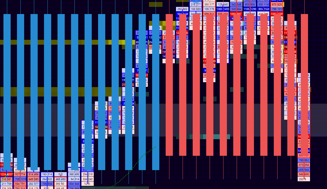

It seems to be sometimes triggered when I use Study Overlay to import a vwap study onto this chart. It doesn't happen every time I perform that action, which I do often. In fact, it is not that consistent. I wish it didn't happen at all.

Thank you. But I do not understand how display order of studies can cause the chart's original candles to be intermittently drawn on top of the numbers bars when I overlay a vwap from another chart. Pr the attached image. Not always, just sometimes.

By chance, something very dramatic just happened. This is new. Please see attached.
Working on chart #12, adding 2 new vwaps. When I clicked ok, this is what happened to Chart  #4 and #19
Chart #4 imports some vwaps from #12. But I was not working on those specific vwaps. I was adding new ones. I did so by duplicating an existing vwaps study and modifying the settings.
Chart #19 imports some vwap studies from #4.
#4 is a candle bar chart. If I set Graph Draw Type to blank like Ackin suggested, then the original bars vanish. The mess on top does not. Those forms in #4 have no relationship to anything I am doing in my charts except they use the same up/down colors.
The only thing I can suggest is that I am using Study Overlay to import several vwaps between charts, and that this is causing a problem. It is a relatively new habit of mine.

User745789 - Posts: 402
Think I found the cause:
1. Chart #12 has vwap1.
2. Chart #4 and chart #19 both import vwap1 using Study Overlay.
3. If I remove vwap1 from #12, then the bars appears per the images.
4. If I hide or remove the Study Overlay (that imports vwap1) on chart #12 and #19, then the bars vanish.
Basically: removing a vwap Study that is the input to a Study Overlay.
