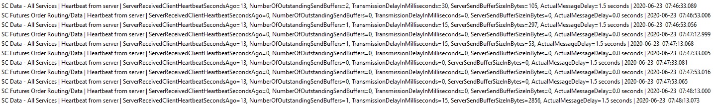

Thank you for the response. I have updated to version 2124 and made the suggested changes to chart interval update times. I experienced some lagging which I believe corresponded with ServerSendBufferSizeInBytes logs up to 2856. Please see attached screen shot. Thanks again.

How much of a lag did you notice? That buffer size is not a problem. The data we see in those messages looks completely fine.
