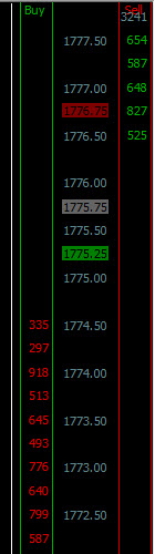

[2014-01-29 15:05:02]
ejtrader - Posts: 689
With OEC - I am using SIM account.
SC(1086):
- price updates OK
- depth update issues (image attached)
- When force reconnected - depth updates work for few seconds but immediately the same issue repeats.
OEC direct platform:
- Price updates OK
- depth updates OK
Date Time Of Last Edit: 2014-01-29 15:11:20
imageSC_OEC_Depth.jpg / V - Attached On 2014-01-29 15:02:49 UTC - Size: 29.03 KB - 610 views
[2014-01-29 16:19:26]
We did become aware of the market depth issue last night. We have to think about how to solve it. OEC apparently is not sending through delete messages as documented.
