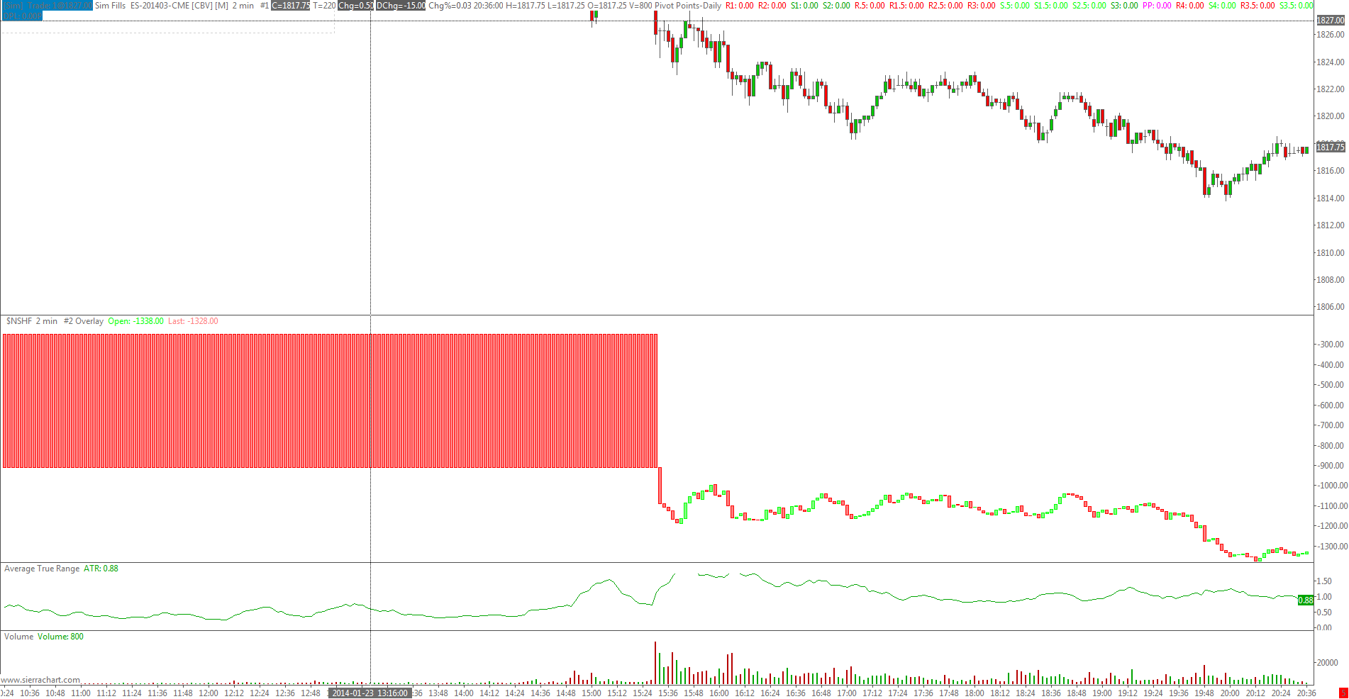

but can anybody tell me how I can get rid of the bars in non NYSE times? like in the image blow in the time before 15.30 (which is my time for opening of NYSE).
Thx again!
http://www.sierrachart.com/image.php?l=1390563023206.png

[2014-01-25 02:20:48]
When overlaying price bars from another chart, to avoid the filler bars use the Study/Price Overlay study.

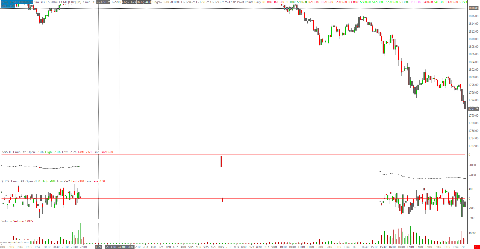

can you give me a hint why the bar at 6.45 shows up??
http://www.sierrachart.com/image.php?l=1390828590617.png
[2014-01-27 16:47:23]
Most probably because there is a 6:45 bar from the source chart you are overlaying the study from.
