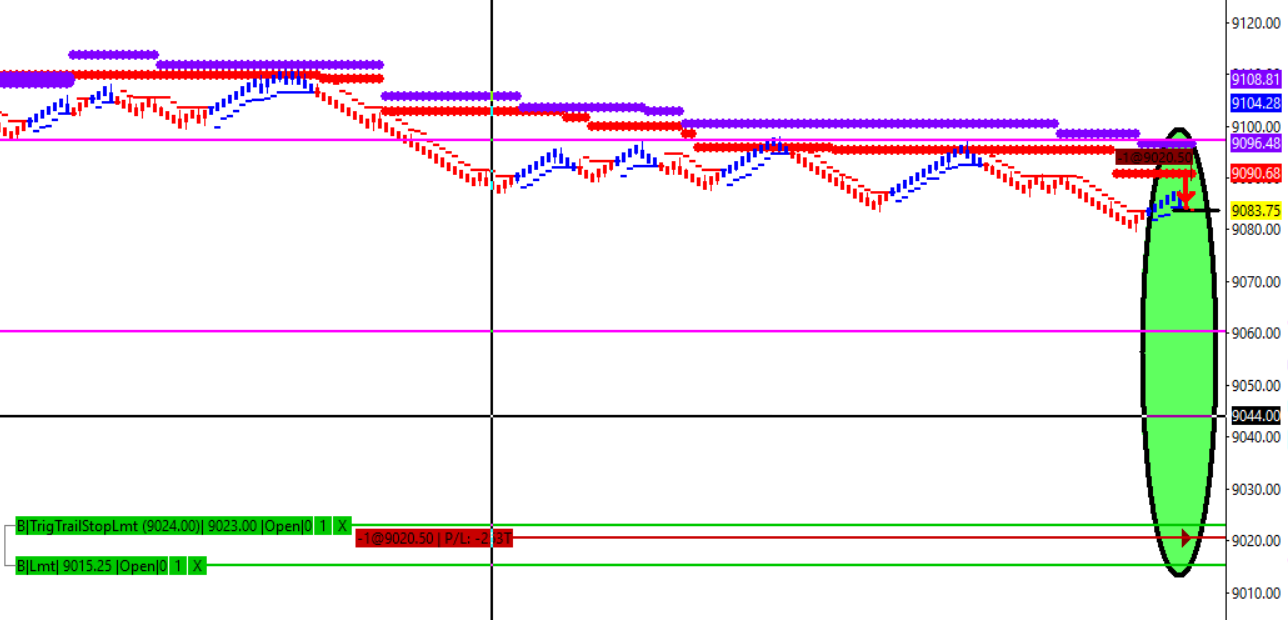

Limit entry orders are being filled above or below the limit entry price which is the previous close bar.The error doesn't happen all the time and happens on long and short trades.
It happens in live sim and replay chart mode
Code snippet below of how i fill an order entry price variable
ShortOrderEntryPrice = sc.Close[sc.Index-1] + Limit_Offset.GetInt()* sc.TickSize;
NewOrder.OrderType = SCT_ORDERTYPE_LIMIT;
NewOrder.Price1 = ShortOrderEntryPrice;
EntryOrderPrice = NewOrder.Price1;
Screen shot attached of trade activity log orderactionsource column.
Also attached is screen shot of incorrect order entry fill on chart.
Any suggestions on how to correct this?
imageSC_incorrect limit fill on chart.PNG / V - Attached On 2020-05-15 02:21:56 UTC - Size: 70.29 KB - 364 views
imageSC_incorrect limit fill.PNG / V - Attached On 2020-05-15 02:22:04 UTC - Size: 5.61 KB - 366 views

This is likely due to invalid bid ask data from the Data Feed you are using. We have no control over that. In this case you are using Transact for data. Refer to:
Trade Simulation: How Orders are Filled
If that is the problem we recommend this data feed:
Denali Exchange Data Feed
Also update to the current version of Sierra Chart:

Spoke with my broker and it is a TransAct issue and they are working on it.
So until the issue is resolved, I have added in a function to check the bid ask spread.
If its over a tick limit set by an input variable,the order is not created until the spread falls within the requirements.
Which is usually within a few tick movements.
