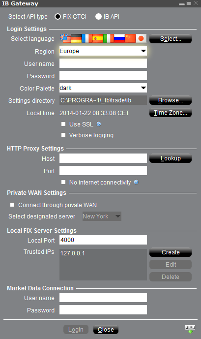

tobi - Posts: 351
In the first login screen it asks to select the API type (s. attached screenshot). Which one should be selected, FIX CTCI or IB API?
Date Time Of Last Edit: 2014-01-22 07:44:34
imageIB-Gateway.png / V - Attached On 2014-01-22 07:44:30 UTC - Size: 42.27 KB - 1376 views
[2014-01-22 09:41:20]
ejtrader - Posts: 689
IB API
