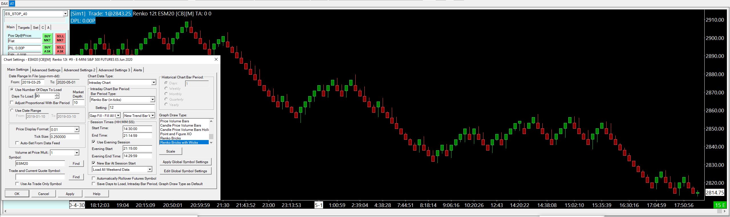

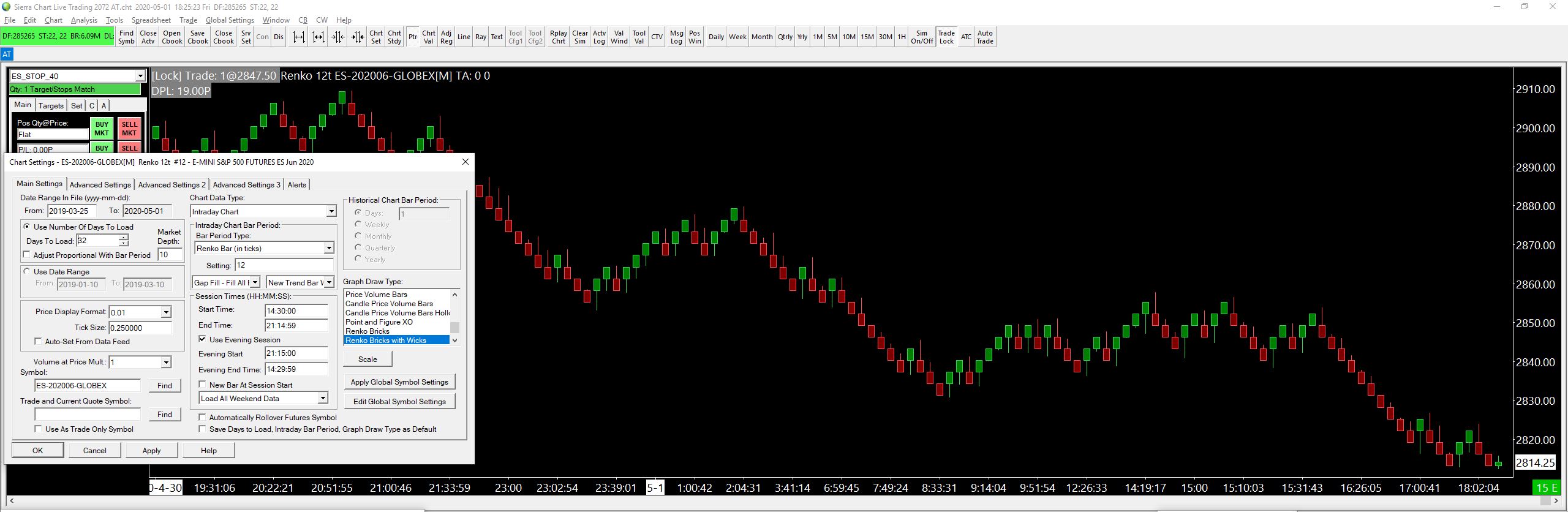

Attached are pictures of two S&P Future Renko charts with 12 ticks setting. The only difference in the charts is that the first charts loads 32 days while the second chart is 90 days continious future chart.
As you can see from the pictures the Renko bricks are not exactly the same (pictures with settings attached). Why are they different and how can make the same?
I am using the continious future chart to backtest my strategies but the diffence in the Renko bricks is screwing up the study signals.
Thanks for your help

image1.JPG / V - Attached On 2020-05-01 17:31:59 UTC - Size: 268.74 KB - 452 views
image2.JPG / V - Attached On 2020-05-01 17:32:05 UTC - Size: 238.4 KB - 412 views
[2020-05-02 08:47:47]
Refer to:
Working With Charts: Resolving Differences of Chart Bars Between Charts
This setting is not the same between the charts:
Chart Settings: New Bar at Session Start (Chart >> Chart Settings >> Session Times >> Intraday Chart Session Times menu)

[2020-05-02 09:24:11]
In this case you need to use the exact same Number of Days to Load in each chart.
