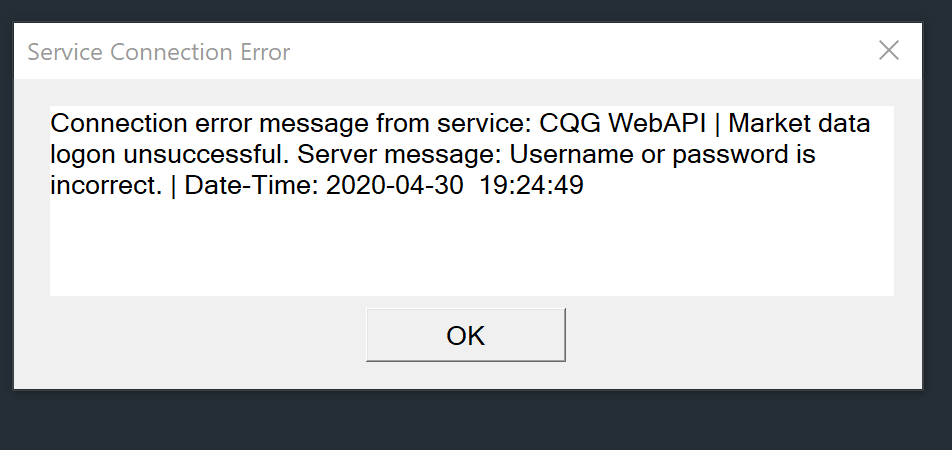

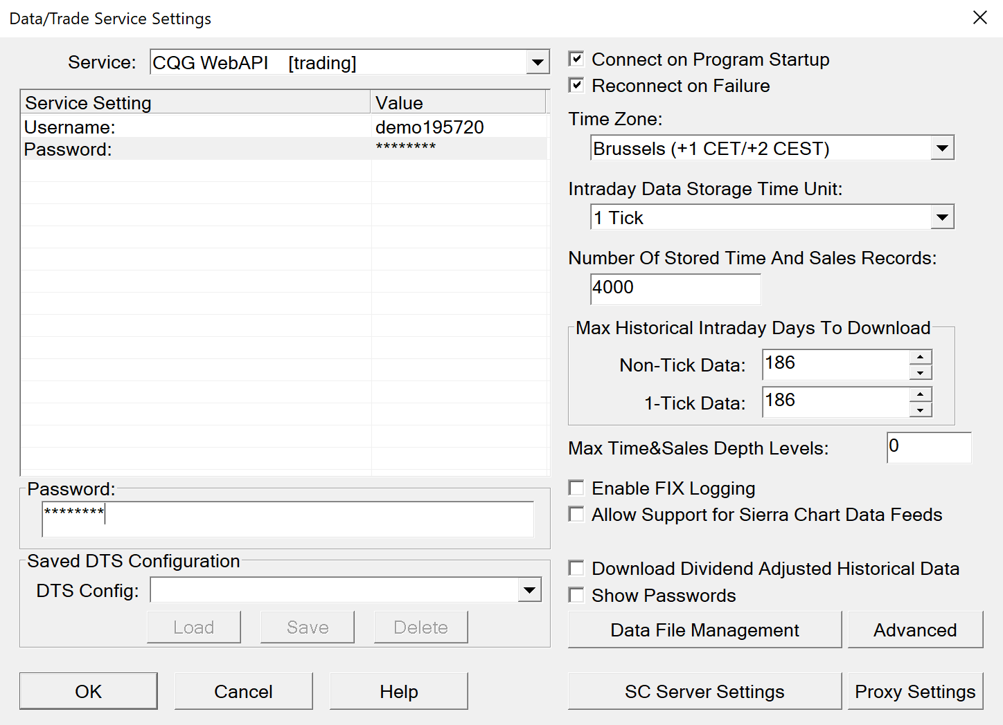

I would like to demo Sierra Chart with CQG. I signed up through AMP Futures for the demo.
When I try to connect to the CQG web API, I get an error, that the username and password are wrong. I double and triple checked, that they are correct, with no spaces, and case sensitive.
Please see the screenshots.
I contacted CQG and they said "You are trying to log into a production environment instead of a demo environment. "
Notice in my screenshot, that I do not have any option in the CQG Web API window to select between Demo or Live.
Please advise.

[2020-04-30 21:51:19]
Sierra Chart does not support CQG demos:
CQG Trading Platform Service: CQG Demo Accounts Not Supported
You need to follow the instructions here instead:
Basic Instructions for Sierra Chart Demo for Brokerage Customers
Skip the steps that have already been completed.
