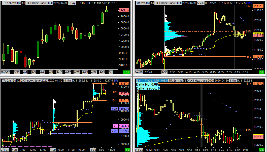

I want to install SC on a new PC. The installation was done with "SierraChartFileDownloader".
Then I copied the "Sierra3.cfg" from the other PC to the new one. Logging was done with the known login data (SC platform and data feed).
I opened an existing Chartbook. The Chartbook contains 8 charts and not more than 30 days are loaded.
DOM and Quoteboard show the current data. All charts are black and are not updated.
No other SC version is open. I have changed the release to 2090 (before 2092)
What is the problem (see pic)
imageEmpty charts.png / V - Attached On 2020-04-30 06:08:00 UTC - Size: 44.29 KB - 308 views
[2020-04-30 07:02:05]
nicktrader - Posts: 817
Don't know why and how but now it works. I opened and closed the Chartbook several times and all at once the data were loaded.
Maybe you can tell me the problem.
imageCharts.png / V - Attached On 2020-04-30 07:01:33 UTC - Size: 40.52 KB - 312 views

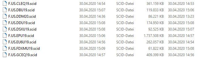

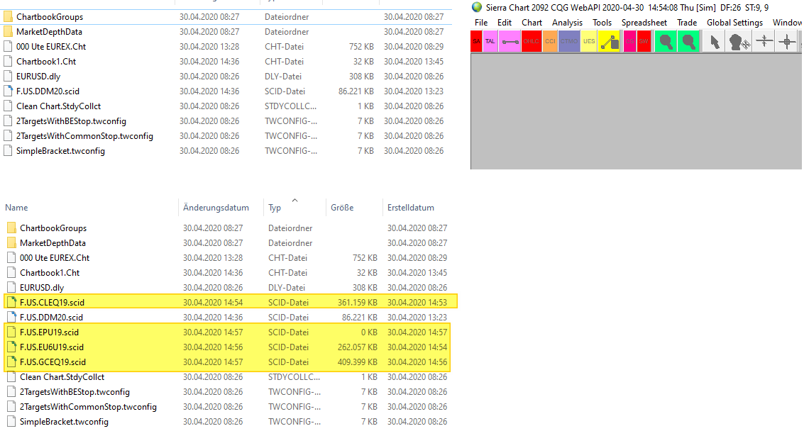

I noticed something. Like I said, installation on a new PC.
To have the same settings, I took "Sierra3.cfd" from the first PC and also a Chartbook.
With the help of "SierraChartFileDownloader" I installed and afterwards I overwrote "Sierra3.cfg" with the existing one from the first PC.
Now I noticed the following. Although I had no Chartbook open, data are being fetched in the "background" (see pic). As far as I can see, the data are coming from the Quoteboard of my first PC. I had set up this QB in October 2019.
This QB is not used at all on the second PC. Could it be that this data are stored in the Sierra3.cfg, especially as it is already noticeable that the data all have the identifier 19.
Because this data, which I don't need at all on the second PC, is loaded in the background, it's no wonder that the PC needs so much time to load F.US.DDM20.

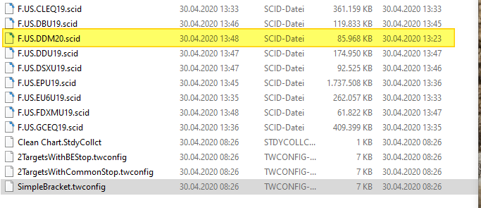

Pls see pic.
Before I opened SC again, I deleted all xxx19.scid files.
Then I started SC and didn't open any Chartbook.
As you can see in the pic, the "xxx19.scid" files are still loaded in the background.
imageStart SC.png / V - Attached On 2020-04-30 13:08:26 UTC - Size: 58.53 KB - 361 views
