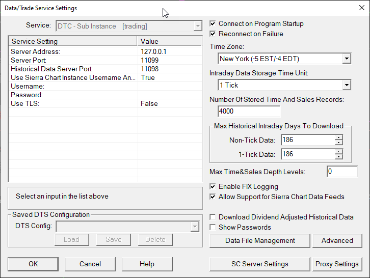

User48838 - Posts: 134
Here are my data settings
Date Time Of Last Edit: 2020-05-05 19:04:36
image2020-05-05_15-02-25.png / V - Attached On 2020-05-05 19:04:31 UTC - Size: 41.65 KB - 325 views
