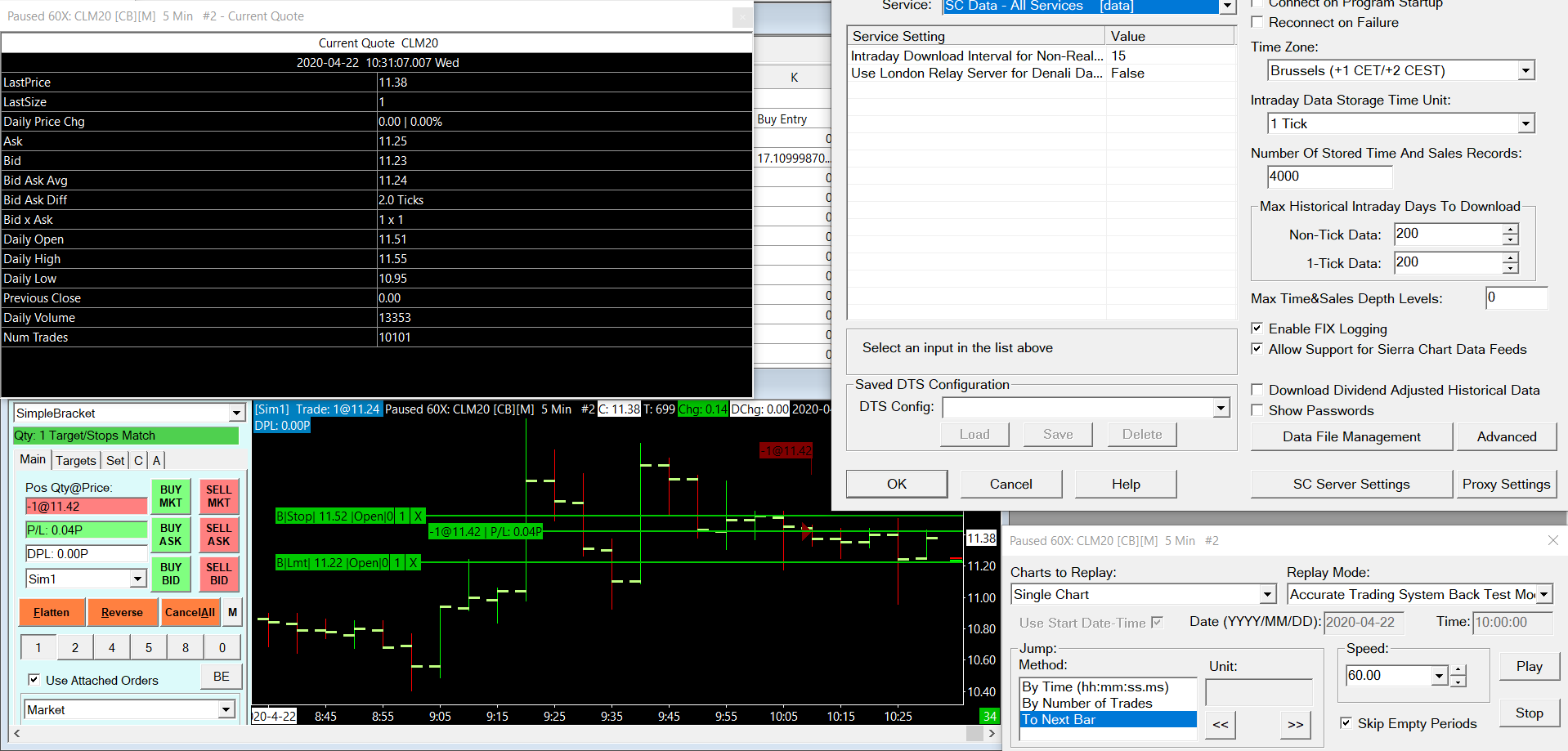

Hello Sierra-Team,

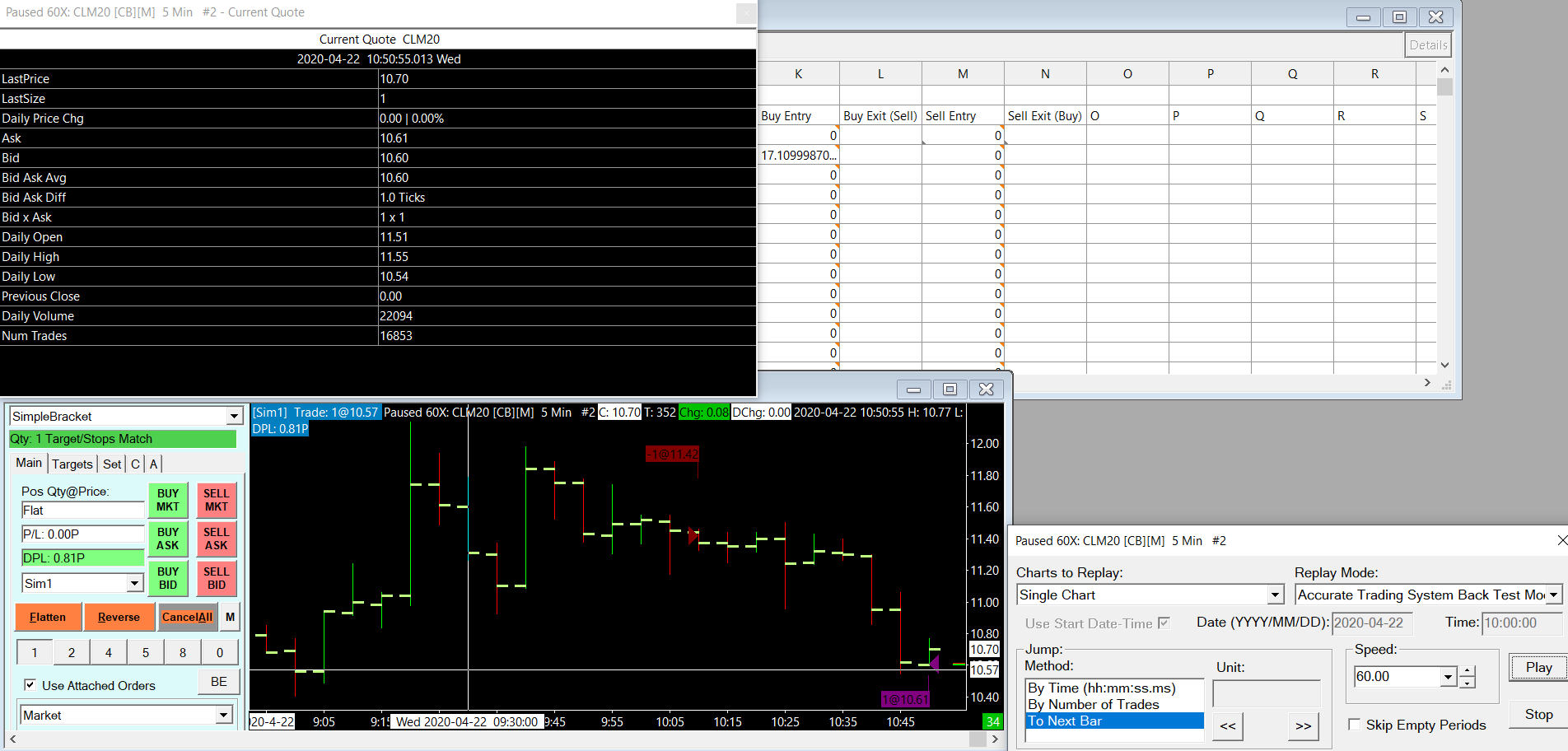

I have created a small automated trading program via spreadsheets. But a backtesting in replay mode gives completely wrong results, because bid and ask are not updated (sometime it takes 3-4 candles).

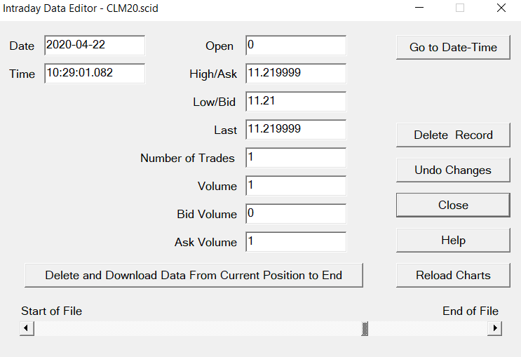

I have read the hint that tick-data are needed here: Auto Trade System Back Testing: Using Actual Bid and Ask Prices During Back Test
But no matter what I set, I get a completely wrong result (40 ticks difference!!). What is wrong here ? Or is there a setting where simply the "current price" is used when touching the LMT order ? Without an approximation any function concerning automated trading is useless if it cannot be tested properly (without running 2 months sim mode in realtime).
Used Sierra-Chart Version: 2088 / package 5
Many thanks for the help.
imageLMT_Not_Executed_during_Backtesting_Trading_System.PNG / V - Attached On 2020-04-27 17:40:56 UTC - Size: 133.53 KB - 347 views
imageLMT_Not_Executed_during_Backtesting_Trading_System_tickdata.PNG / V - Attached On 2020-04-27 17:41:00 UTC - Size: 19.34 KB - 336 views
imageLMT_Not_Executed_during_Backtesting_Trading_System_wrongFill.png / V - Attached On 2020-04-27 17:41:05 UTC - Size: 109.29 KB - 428 views
[2020-04-27 18:53:38]
We want you to use Sierra Chart version 2092 and see if it resolves the issue:
But if at times, there is a problem with the bid and ask data from the exchange not being up-to-date, then what we recommend doing instead is changing the Intraday Data Storage Time Unit to 1 Second:
Data/Trade Service Settings: Intraday Data Storage Time Unit (Global Settings >> Data/Trade Service Settings >> Common Settings >> Common Settings)
Date Time Of Last Edit: 2020-04-27 18:56:21
[2020-04-27 19:12:26]
User355493 - Posts: 27
Thank you.
With the update it seems to work now. Unbelievable, so simple... and I´ve tried different settings for some Hours also this one which you mentioned above and which is described here:
Trade Simulation: Trade Simulation Accuracy and Bid/Ask Prices During Replays
