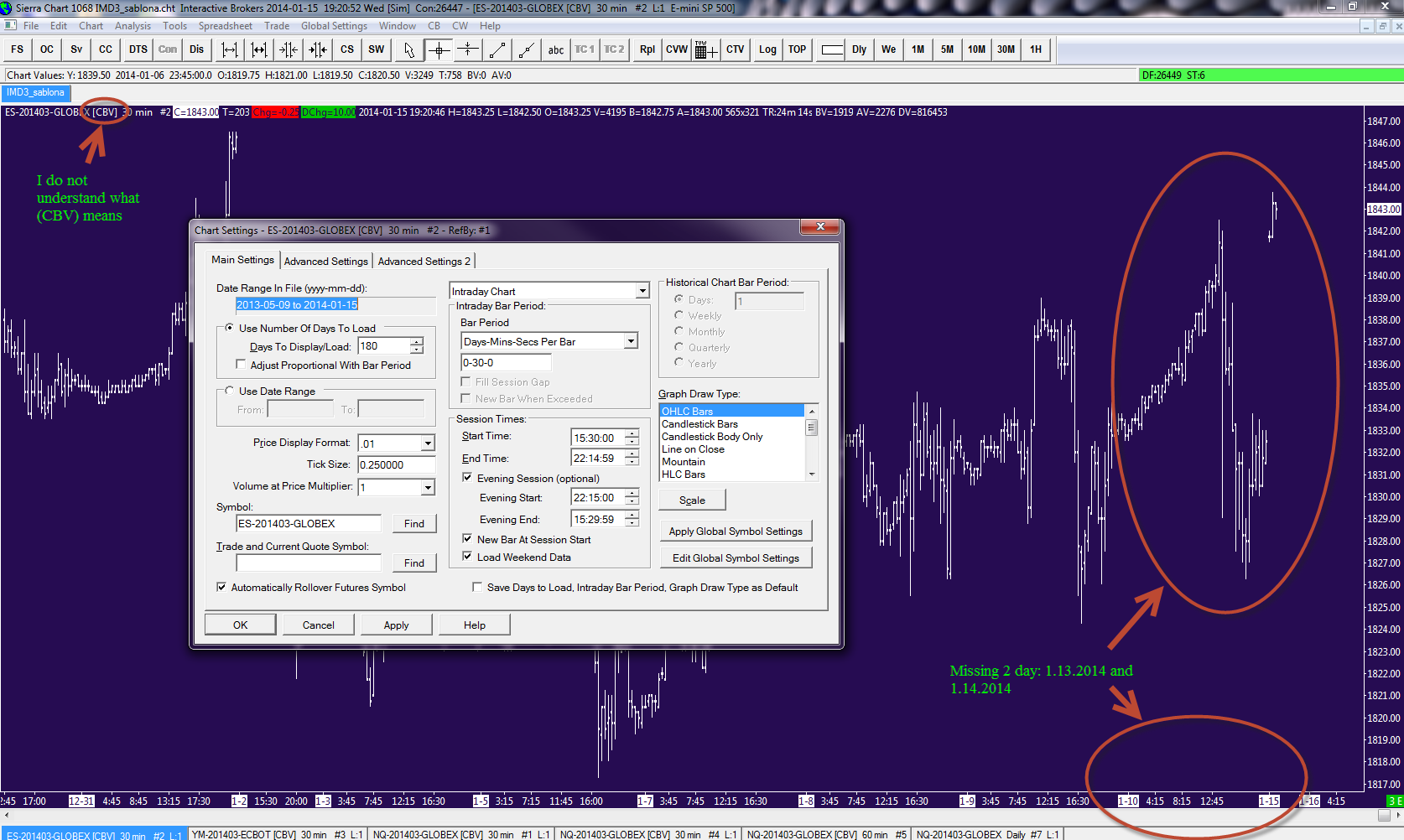

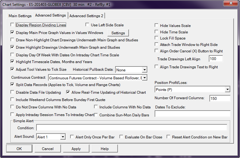

I have got problem with rolling over to a new futures contract month. There are several possibilities how to rollover but I am not native English speaker and it is quite difficult to find the right way. I would like to ask you to give me exact guideline how to rollover. Here is my demand: I have got chart of future contract for example ES_2013_12 (e-mini S&P) with history starting from, let’s say, 9.30.2012 and I want to rollover to the new contract month ES_2014_03 and the history has to remain from 9.30.2012 as backadjusted. I would like to get simple quideline that I can use from now forever when rollingover.

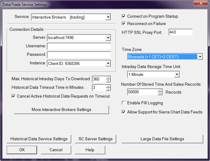

This time I have tried to rollover according to your help on your website. And I have got problem with downloading datas to my chart. For example I was last loged in Sierra on Friday 1.10. and when I have loged in today I can see in my chart datas only till 1.10.2014 and 1.15.14 from the time I have loged in. There are no datas for days 1.13. and 1.14. between.

1. The first step is to update Sierra Chart to version 1077 or higher. See 2 below for help with this.
1.1. To fill in the missing data in your chart, refer to help topic 7.1 here:
http://www.sierrachart.com/index.php?l=doc/helpdetails7.html#RefreshWithData
1.2. Set Chart >> Chart Settings >> Advanced Settings >>Continuous Futures Contract - Date Rule Rollover, Back Adjusted.

3. For a description of the Continuous Contract indicators you see on the chart (CBV), refer to the bottom of this page:
https://www.sierrachart.com/index.php?l=doc/doc_ContinuousFuturesContractCharts.html#RolloverOptions
