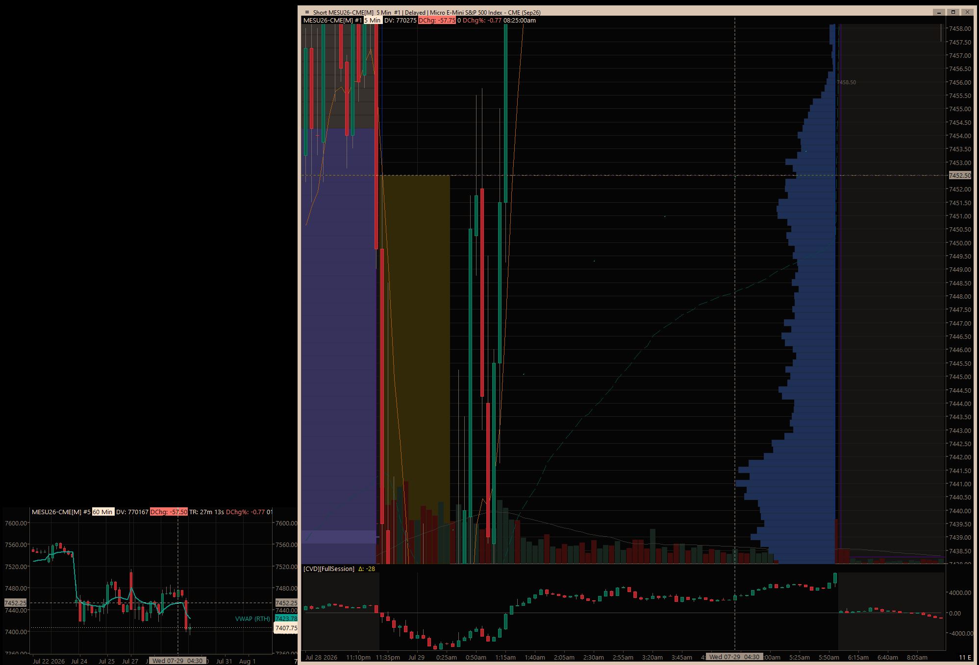

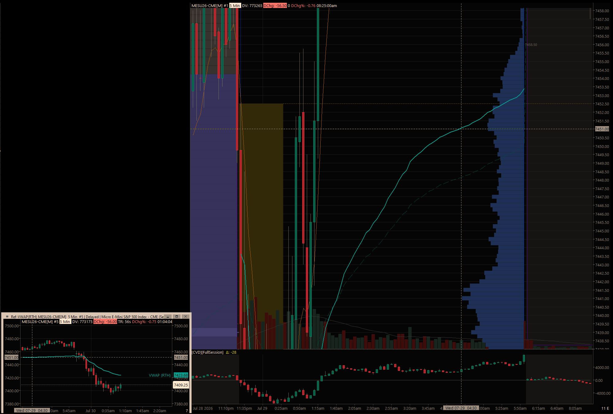

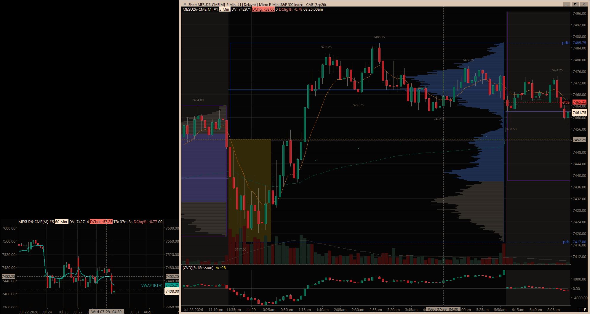

How.tf - Posts: 10
No, on the source chart the VWAP remains the same regardless of the candle timeframe I choose.
On the main chart (full session one, where the VWAP is overlayed) - the live RTH-VWAP (ie as of the current bar) is not affected by the change in timeframe of the source chart #5.
It is the only the historical charting of that VWAP line that changes - see screenshots attached as i change from 60min - to 30min - to 15min - and then 5min on the source chart.
I have left my mouse cursor at a fixed spot on the main 5min chart for reference -
- As a control base - this mouse cursor is left at the charted VWAP (small blue dot) as at Wed 07-29 04:30, when the base chart #5 is [60min] - VWAP shown is 7452.25 (Image_60MinBase)
- As I switch the base chart #5 to [30min], you can see that the new VWAP (small blue dot) calculated as at Wed 07-29 04:30 has moved lower (Image_30minBase)
- This continues as I switch to [15min] and [5min] on the base chart #5 (Image_5minBase). The VWAP as at Wed 07-29 04:30 gets progressively lower as I change my Source Chart #5's timeframe lower from 60min -> 5min.
Date Time Of Last Edit: 2026-07-29 15:10:52
imageImage_60MinBase.JPG / V - Attached On 2026-07-29 15:08:50 UTC - Size: 209.17 KB - 107 views
imageImage_30MinBase.JPG / V - Attached On 2026-07-29 15:08:56 UTC - Size: 203.73 KB - 122 views
imageImage_5MinBase.JPG / V - Attached On 2026-07-29 15:09:08 UTC - Size: 198.79 KB - 109 views

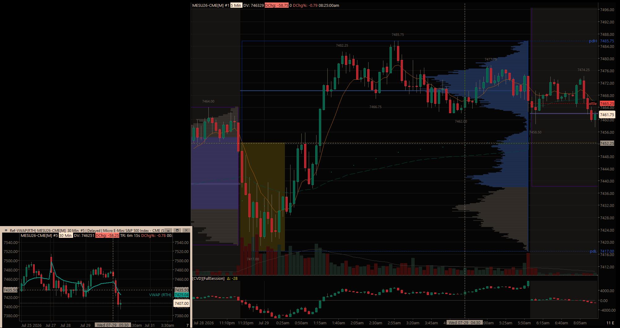

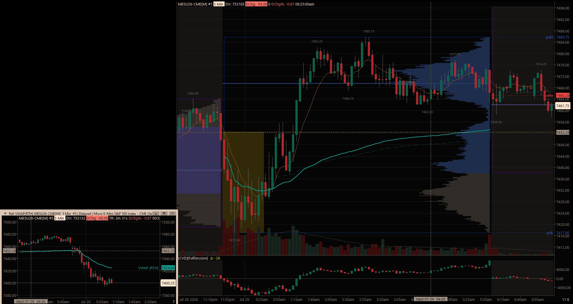

[2026-07-29 15:17:45]
How.tf - Posts: 10
I have attached additional images, zoomed in on the point, as at Wed 07-29 04:30, to make it clearer
- When Base Chart #5 is on [60min] - VWAP at Wed 07-29 04:30 = 7452.50 (Image_60MinBase_ZoomedIn)
- When Base Chart #5 is on [5min] - VWAP at Wed 07-29 04:30 is 6 ticks lower (Image_5MinBase_ZoomedIn), with VWAP = 7451.00 (shown with cursor placed there in (Image_5MinBase_ZoomedIn_ShowingNewVWAP).
imageImage_60MinBase_ZoomedIn.JPG / V - Attached On 2026-07-29 15:17:33 UTC - Size: 227.88 KB - 136 views
imageImage_5MinBase_ZoomedIn.JPG / V - Attached On 2026-07-29 15:17:36 UTC - Size: 222.37 KB - 130 views
imageImage_5MinBase_ZoomedIn_ShowingNewVWAP.JPG / V - Attached On 2026-07-29 15:17:40 UTC - Size: 228.99 KB - 136 views
[2026-07-29 16:13:52]
We are not understanding these images as we do not see the line you are trying to reference. For instance, in the image named "Image_60MinBase_ZoomedIn.JPG" you state that the VWAP is showing a value of 7452.50 at 07/29 04:30. But there is no actual line showing at that level in the image.
What you have to keep in mind is that if you are using the "Last" (the default) for the Input Data, then when different Bar Periods you will have different VWAP values at a specific bar time. You would need to compare the bars that ended at the same time to see that the data is lining up. The most current bar will always match, as this has the same ending time in both situations.
For instance, with a 5 minute and 10 minute bar period. If you look at the 09:30 bar the VWAP values will be different between the two bar periods. What you would need to look at is the bar that has a Start Time of 09:25 in the 5 minute chart and the bar with a Start Time of 09:20 in the 10 minute chart. These both have an ending time of 09:29:59 and therefore have the same VWAP value at that time.
Therefore, when you overlay different Bar Periods to another chart, you are going to see differences in the VWAP values, as the Start Time of the bars is used to map between the charts.
