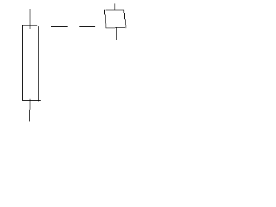

Volume Candles are not being correctly created. See attached incorrect image file. The candles are being repeated instead of being properly aggregated, those candles show gaps because the open in not at the previous candle's close.
If a large block of stock trades that needs to be split between multiple candles, it should be done as in the attached sample image because the stock trades all at the same price.
Could you please correct this problem?
imageIncorrectVolumeBars.png / V - Attached On 2014-01-14 14:22:41 UTC - Size: 9.12 KB - 573 views
imageSampleCandleDrawing.png / V - Attached On 2014-01-14 14:30:52 UTC - Size: 1.33 KB - 614 views
