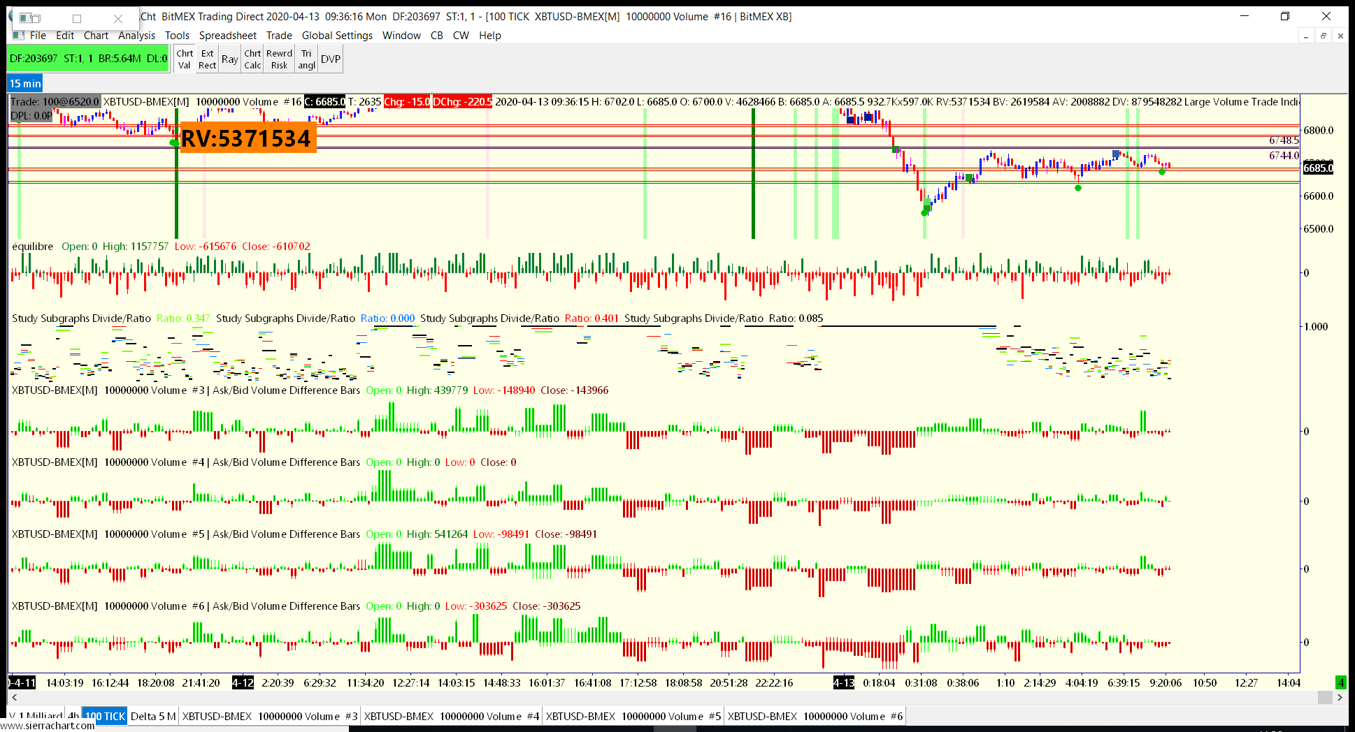

User719206 - Posts: 93
http://www.sierrachart.com/image.php?Image=158677057672.png
This is what i get with the best willingness of the word , the ask and bid difference normal is at the top , and under , you have the 4 ask and bid diffrence with the different volume filter ( 0 6000 , 6001 15000, 15001 40000, 40001 and above ), if i add the 4 ask and bid difference i m supposed to get almost the same result than the top one, but there is absolutly no links betweens the results.
