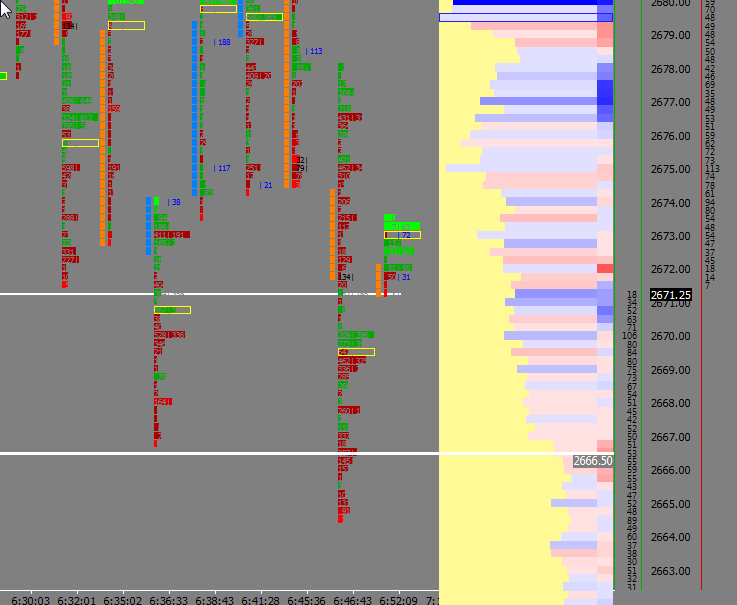

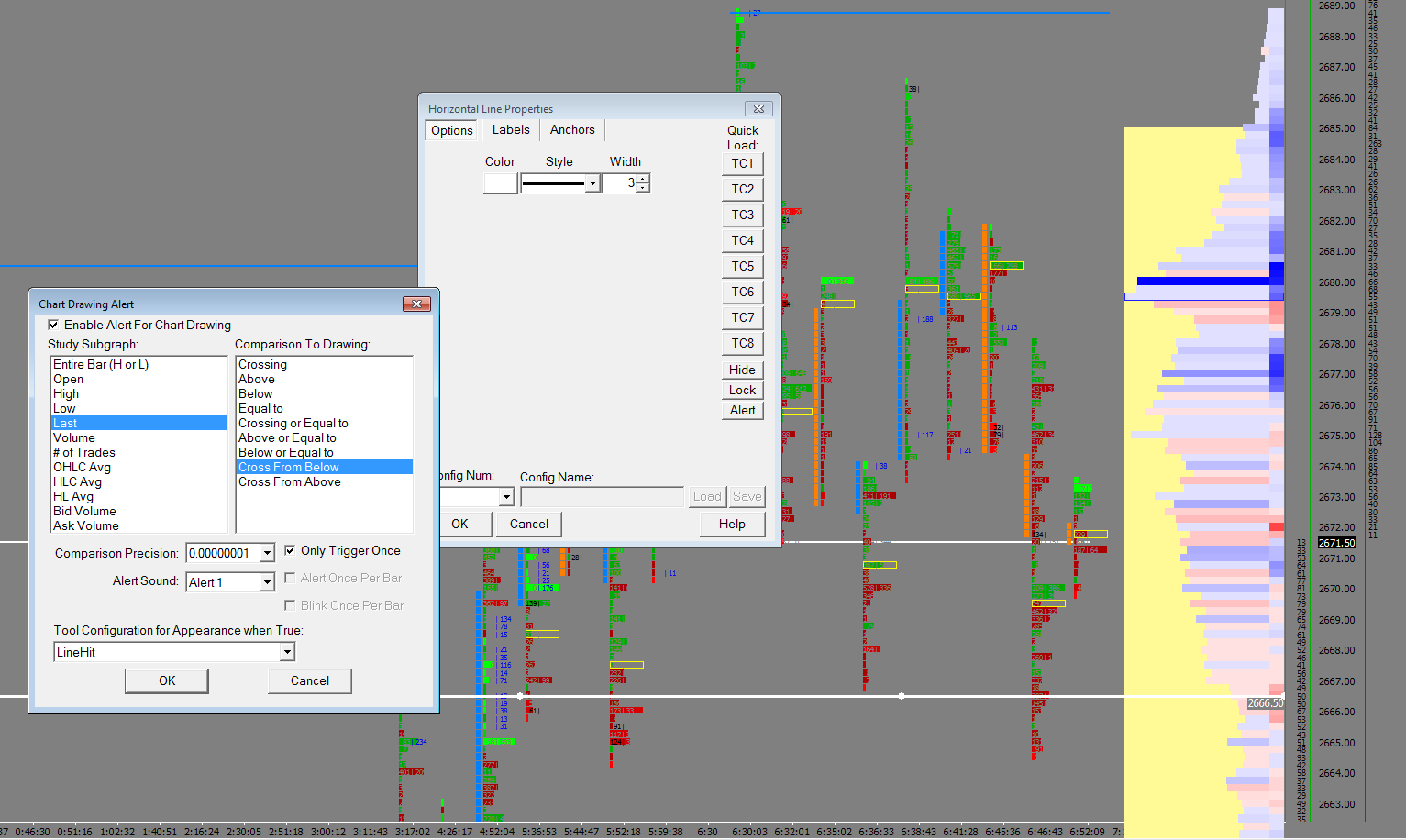

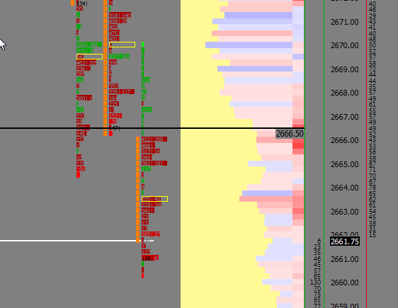

I have a 30T Reversal Chart. When price was trading at 2670 I placed a horizontal line at 2666.50. This had a alert attached to it with a LAST Crossing from Below on it.
So I expected that when price would go BELOW 2666.50, then cross back ABOVE 2666.50 I would get a alert. But as you can see that didn't happen. Please let me know how I can fix this?
When the alert is generated, it changes to a black line using the a "Line Hit" config.
imagealert1.png / V - Attached On 2020-04-08 13:58:30 UTC - Size: 27.76 KB - 368 views

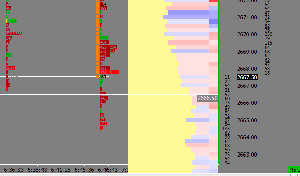

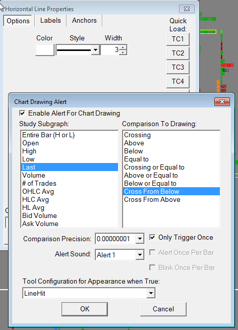

Here is the last two screen shots. #5 shows the alert after it was triggered, which was 2 bars later. I'm not sure why it fired then.
imagealert4.png / V - Attached On 2020-04-08 14:00:20 UTC - Size: 107.37 KB - 372 views
imagealert5.png / V - Attached On 2020-04-08 14:00:25 UTC - Size: 24.23 KB - 323 views
[2020-04-08 20:13:07]
John - SC Support - Posts: 48062
Take a look at the following and see if this could be the problem:
Chart Drawing Tools: Chart Drawing Alert Not Triggering When Expected
Date Time Of Last Edit: 2020-04-08 20:13:54
[2020-04-08 20:19:57]
User502498 - Posts: 33
I checked that, and my update interval is 150ms. This took WAY longer than a few seconds.
[2020-04-08 20:48:17]
Can you please attach the Chartbook to this thread so we can take a look at the setup. We tried running this with a Renko setup ourselves, but we are not having any issues.
