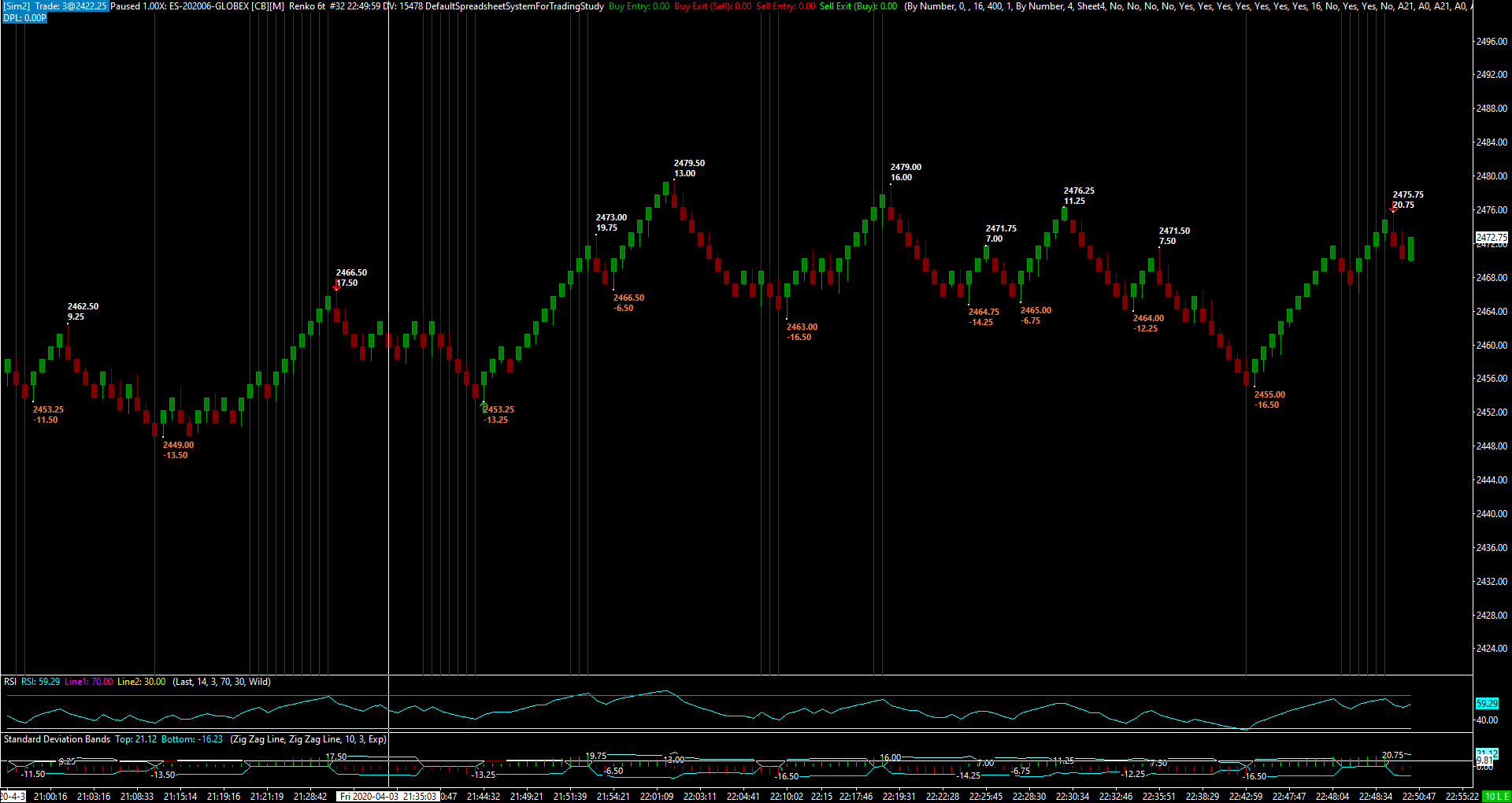

I am facing some calculation problems when using the standard deviation bands study and I would appreciate your input.
I have set up a "colour background based on alert condition." The alert condition is when the top standard deviation band is less than 3.
I put the chart in replay mode and I observe that when there are continuous bars that need to be colored, the program fails to do so "live" but when i hit recalculate it does....
You can check ES futures 3/4/2020 from 15:48 to 15:50 EST for example.
Is there any setting I can change in order to have the standard deviation bands calculations correctly plotted?
Thanks in advance!
when in replay mode
http://www.sierrachart.com/image.php?Image=1586114285552.png
after recalculate:
http://www.sierrachart.com/image.php?Image=1586113977308.png

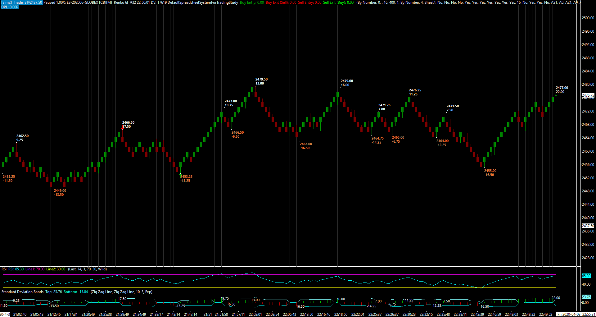

I'm currently testing 2115 at the same time/day as the OP and even though it's greatly improved, I'm still getting 2-3 bars not properly calculated.
Can you please investigated further?
I have set up an automated trading strategy and its very crucial for this.
Thanks in advance.

nikos - Posts: 25
currently on 2138 and still having issues....
Are you willing to investigate further?
