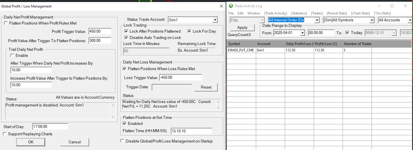

It seems like Global Profit and Loss shows 1/10th of the real loss!! I was trading ES, not MES and the Trade Log got my loss right, why is Global PNL different?
Date Time Of Last Edit: 2020-03-31 23:25:55
[2020-04-01 20:11:03]
nosast - Posts: 327
Updated to 2074 and did some SIM losses. Still the PNL for Global PNL management shows only 1/10th of the real loss. Looks like GlobalPNL-Mgmt. thinks I was trading MES instead of ES. How come these could differ? Is there anything to change this? I already resetted and re-activated GPNL-Mgmt without any diffence.
see attached
imageSNAG_ 2020-04-01 - 22.08.21.png / V - Attached On 2020-04-01 20:10:58 UTC - Size: 67.39 KB - 655 views

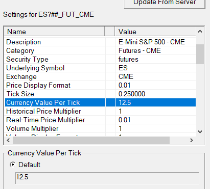

We apologize for the delay with this. We need a little more time to look this over. But check the Currency Value Per Tick in the charts in the Chart Settings used for trading.
[2020-04-02 12:00:56]
nosast - Posts: 327
Curreny value per tick is correct. I checked this already. If I would change it here - the Trade Activity Log would also show wrong numbers.
imageSNAG_ 2020-04-02 - 13.59.04.png / V - Attached On 2020-04-02 12:00:50 UTC - Size: 16.48 KB - 411 views
[2020-04-03 11:18:36]
You need to check that value in the Chart >> Chart Settings for the particular chart that has a wrong profit/loss value. Refer to:
Profit/Loss Calculations and Symbol Settings

We need to understand this better. We need a full screenshot of the Trade Stats for Charts tab of the Trade Activity Log showing all of the Daily Net PL values.
And we need a screenshot of the profit/loss value you are referring to in the Global Profit/Loss Management window.
There simply cannot be any discrepancy between the two.
You can privately attach them here.
Date Time Of Last Edit: 2020-04-04 11:32:07
[2020-04-03 12:04:37]
nosast - Posts: 327
Attachement in post number 2 is not sufficient?

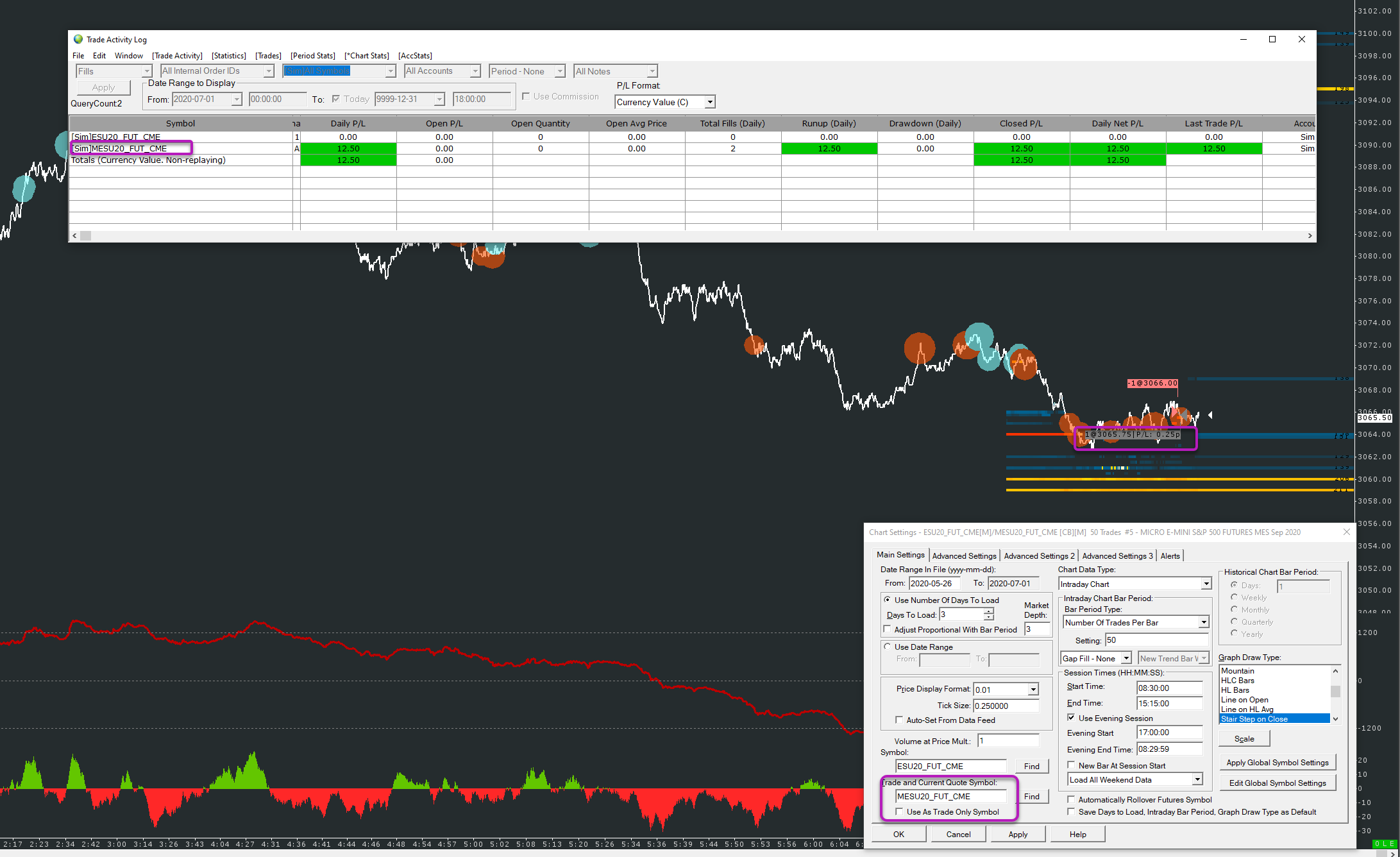

[2020-07-01 11:54:27]
nosast - Posts: 327
This is still not working for me. I want to quote ES but trade MES. All works fine but the PNL in charts trade tab and Global PNL management is wrong and based on ES instead of MES. See attached where a 1 tick profit with 1 MES contract results in 12.50 USD currency value.
imageSNAG_ 2020-07-01 - 13-51-48.png / V - Attached On 2020-07-01 11:54:23 UTC - Size: 164.7 KB - 465 views
[2020-07-01 19:05:55]
Refer to this setting:
Chart Settings: Currency Value Per Tick (Chart >> Chart Settings >> Symbol >> Symbol Settings menu)
