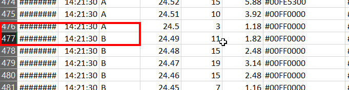

With this recent change in market liquidity i have notices Denali depth become unstable, I was under the impression that we can see 800 levels of depth on the bid and on the offer. I trade with a decent amount of Seirra users and we are all experiencing the same issue.
As you can see based on the data, I am only able to see 450 prices on the offer, and 481 on the bid.
Please let me know

For crude oil right now we see 392/480 levels each side. Knowing how everything is implemented on the server with processing of the market by order data, this could not be an issue at the Denali application level.
CQG is showing 392/400. So you can see CQG is missing 80 levels!

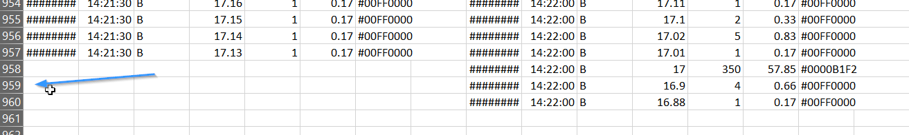

Ok but u can see in pictures above the bid depth was seen at 142130 was only visable to 17.13 price then at 142200 they were able to see to 16.88 and price was only 2 ticks difference. So does that mean price was limited to 480 levels and didn't see the 16.88 till some pulled orders ? As u can see there is major issues with the big orders screwing up the bar visual

we do see that but issue is if larger size trade comes in above that there is a big drop off in the depth from the bars not seeing that bid/ offer when price moves away from that level , meaning if price is at 50.00 and it can see 400 levels on bid it and the last bid is at 46.00 and some one has a 300 lot at 45.99 and price moves up and down 1 tick its going to have this big 300 point change in depth bar . and this is happening alot so just asking if maybe you can add option to keep taht scale ? pic below

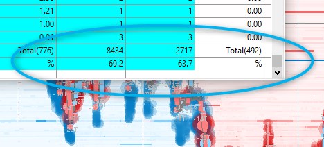

See Example of (Denali Data Feed) Bid - Ask depth bar difference not calculating correctly.
Please take a look at attachments -- all the traders in my group have this issue
imageDenali Bid (8,434) + Ask (2,717) - Market depth window total.jpg / V - Attached On 2020-04-06 00:12:45 UTC - Size: 32.56 KB - 585 views
imageDenali - Depth Bar showing 10,851 but should be 5,717 (Bid (.jpg / V - Attached On 2020-04-06 00:12:58 UTC - Size: 1.95 KB - 482 views
imageDenali - Mode = difference (bid - ask).png / V - Attached On 2020-04-06 00:13:17 UTC - Size: 44.77 KB - 507 views
[2020-04-06 00:20:15]
User852559 - Posts: 43
As an added data point this issue occurs when the filter for bid/ask depth calculations is set to 800 or 0 (unfiltered). If you apply the filter of 799 levels or lower the calculation appears to work normally.
