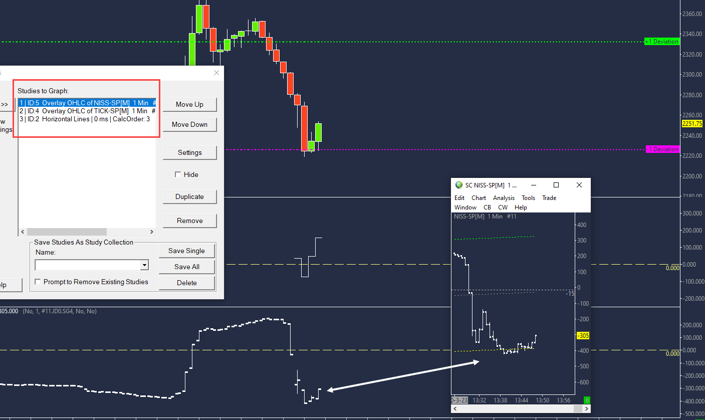

I am using the 'study overly - ohlc' on a 5minute chart.
I have referenced a 1 minute NISS-SP chart and set it as region 2.
The problem here is that your documentation says that I am supposed to see 1 minute candles but this study automatically sets the reference chart to whatever timeframe I set the main chart to be.
I would like the study to stay at the timeframe of the reference chart no matter what I set the main chart to.
How do I achieve this?

[2020-03-23 13:51:43]
grantx - Posts: 244
I am using exactly that study. See attached.
See that arrow? On the study window under my main chart it has changed the size from 1 minute to 5 minute bars.
Yet on the chart I am referencing, it is a 1 minute chart.

[2020-03-23 18:07:12]
The closest you can get to what you want is by using this study:
Study/Price Overlay Study
[2020-03-23 19:40:02]
grantx - Posts: 244
Nope. That doesn't work either. Your documentation says:
"This is useful to be able to create OHLC bars for a study to see its range of values during a longer duration bar by referencing the study Line/Subgraph on shorter duration bars."
So, is it possible to put a 1 minute timeframe study onto my 5 minute chart without the study resetting to 5 minute?
[2020-03-24 03:18:47]
There is a misunderstanding as to what that is describing. In this case the one minute bars are combined into a five-minute bar.
