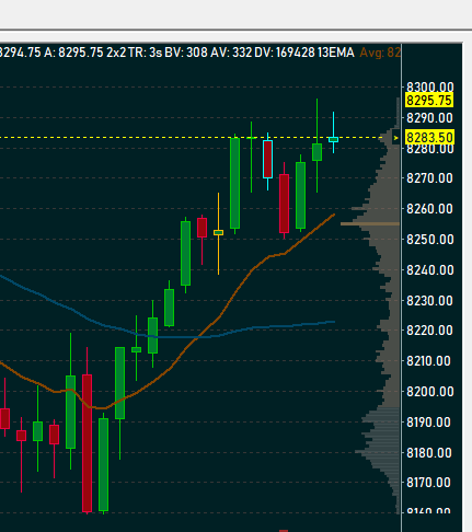

mbilyanov - Posts: 62
Suddenly the bars are not updating anymore and the price line study will stay at one price level as the price indicator keeps moving in accordance to the price.
I'm on v2058 and Denali, I'm on the NQ instrument.
Any ideas?
(I know, the image I have uploaded is just a static image, but the bar is just sitting there, not redrawing and the price line is just sitting there, the darker yellow box is the actual price box, that keeps moving).

[2020-03-10 11:53:00]
Refer to help topic 3:
Most likely because the Session Times settings in the chart are filtering out the current data:
Intraday Chart or Chart Bars Not Updating | Blank Intraday Chart | "Currently no data to display" message for Intraday Chart: 3.3 - Session Start Time and End Time not Covering Current Time

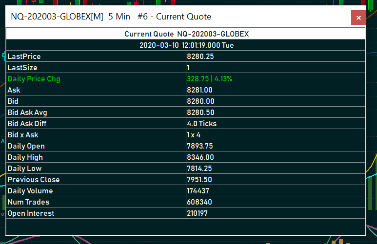

But, it was all working fine a minute ago. I have not changed anything. Please see the attached video.
(Nothing is moving or refreshing apart from the DOM and the price-box).
The Quote window is fine, which means my data feed is (potentially) fine.
Date Time Of Last Edit: 2020-03-10 12:02:31

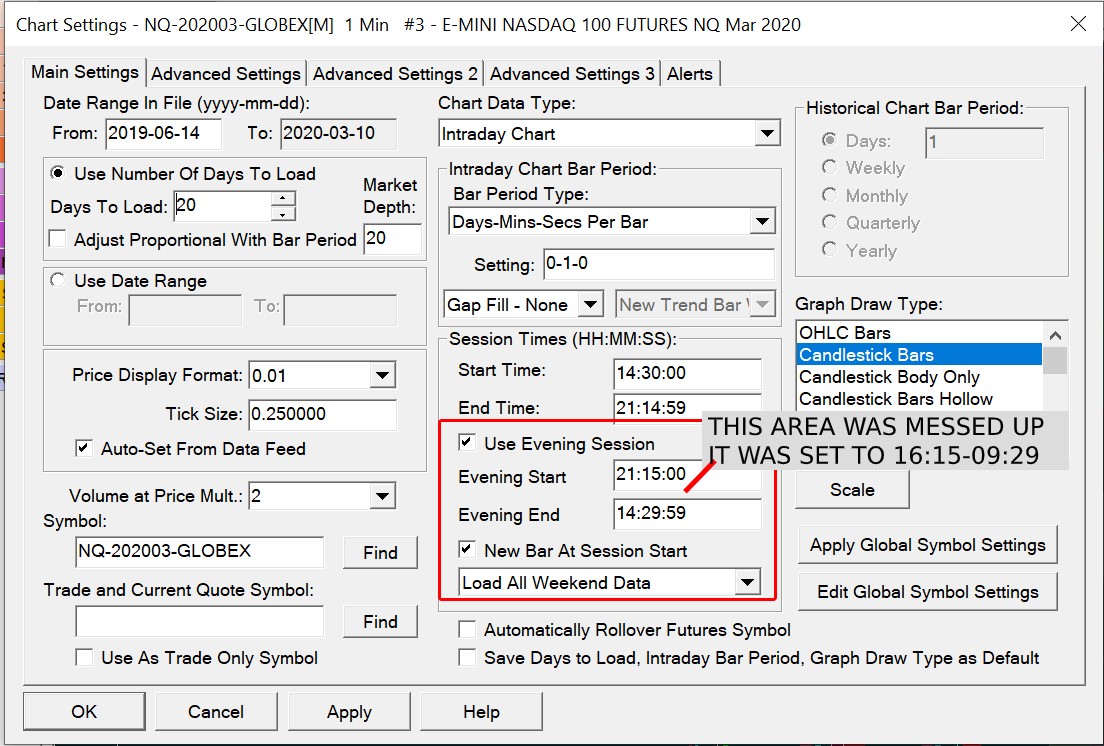

[2020-03-10 12:16:08]
Ok. It is fixed now. Thanks for the link. The session times were messed up some-how. I swear I have not touched anything related to session times.
imagecs.png / V - Attached On 2020-03-10 12:15:59 UTC - Size: 59.08 KB - 387 views
