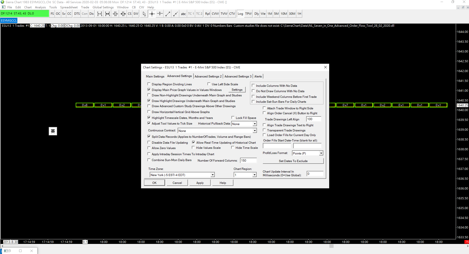

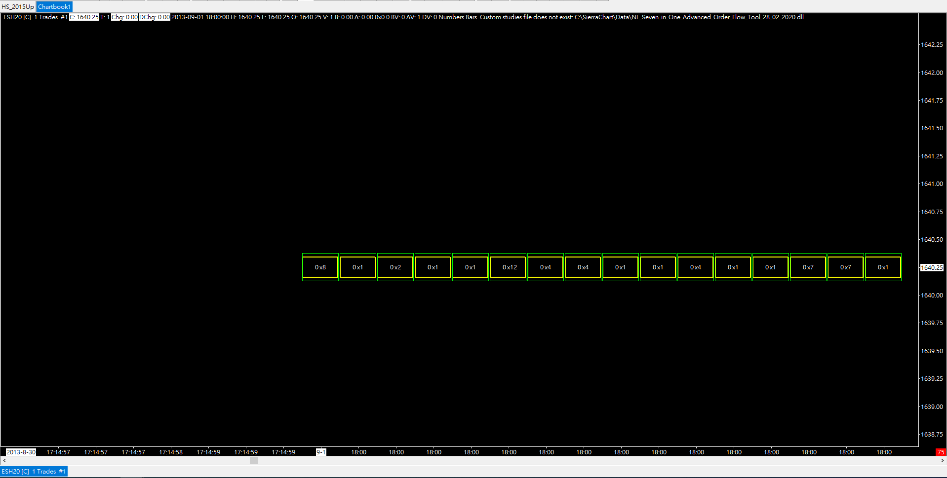

On 2013-09-01, the ES futures opening time should be at 17:00 instead of 18:00 due to daylight saving time. May I ask what should I do to adjust the daylight saving time automatically instead of doing it manually every time when there is a shift as I plan to export a long history of time series price data for doing back-testing.
Please find the attached photos for indicating my current situation.
Thank you very much.

You just need to set that chart to use the US Eastern time zone:
Time Zone Setting: Using Different Time Zone in Individual Charts
And then set the Session Times in the chart according to that time zone:
Chart Session Times
[2020-02-04 06:18:55]
User14410 - Posts: 38
I have already set to New York, please refer to my two photos, but the time should be at 17:00 instead of 18:00. What did I do wrong?
[2020-02-04 06:24:44]
The data was on 01/09/2013 (DD/MM/YYYY) and the opening time for ES futures should be at 17:00 instead of 18:00. You could see that there was 45 mins gap in the attached photo and that might imply the opening time was incorrectly displayed.

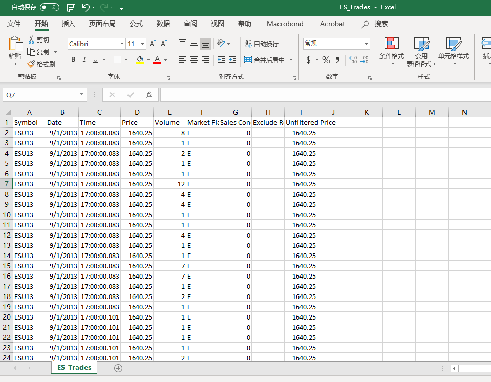

I have double checked with some other data vendors' sample data and found that the time should be at 17:00 also. Please confirm if there is any problem with the data. Thank you.
[2020-02-04 16:46:29]
Can anyone please help me to verify whether there is a problem?
I have attached two photos for indicating the opening time might be incorrect.

Make certain the chart is set to the US Eastern time zone:
And then follow the instructions here to apply the default Session Times to the chart:
Global Symbol Settings: Applying Global Symbol Settings to Existing Intraday Chart

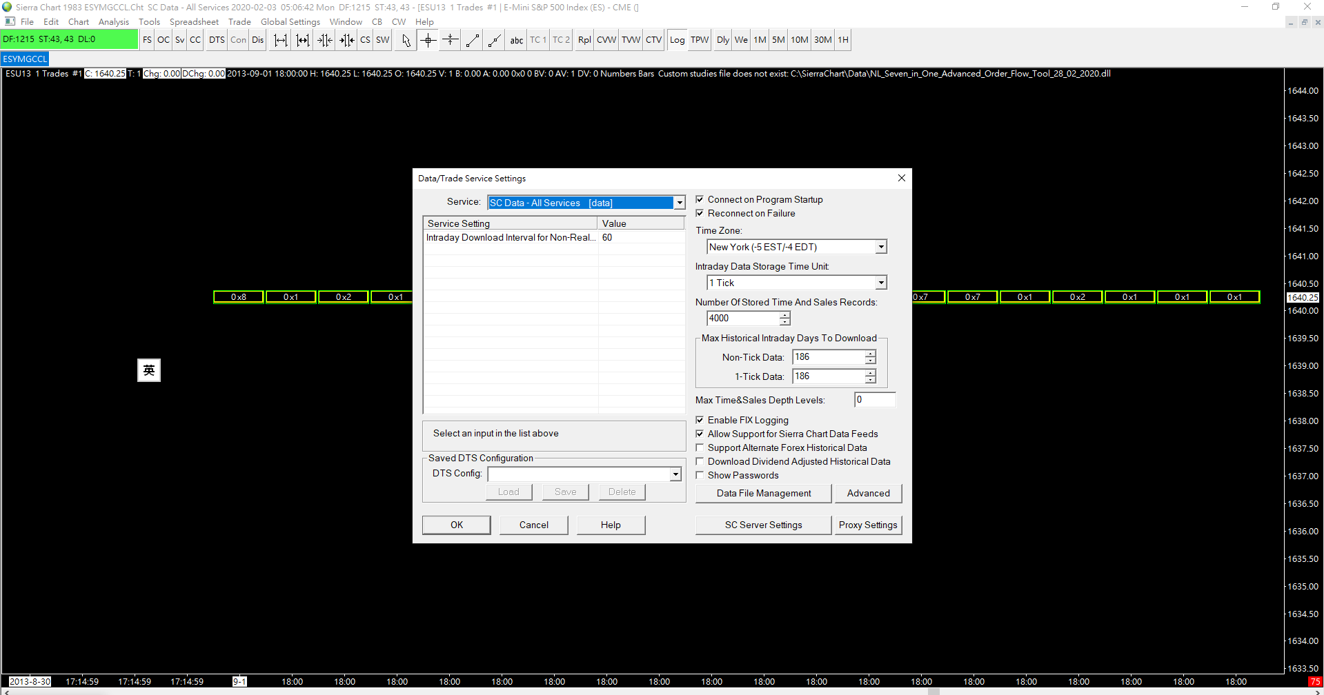

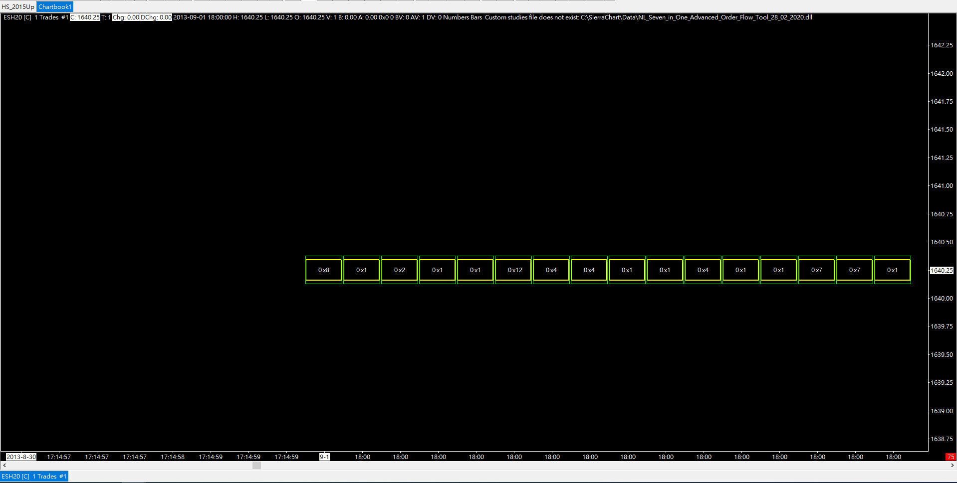

[2020-02-04 20:10:49]
I have set to New York time and followed the steps you advised, but the result is still incorrect. Please see the attached photo, especially the time for the 45 minutes gap, for indication.

[2020-02-05 11:02:46]
Thank you, but I believe there might be misunderstanding. Please take a look at the tick data sample from "tickdata" vendor and compare with the other photo I attached.
You could see that the trade price and bid-ask volume have the same pattern in both photos, but there is a one-hour difference.
