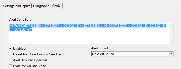

Some times the code gets too convoluted to read what I was intending to do. so I would like to add comment in the alert pane either above or below the code. Is it possible?
imagealert pane.PNG / V - Attached On 2020-01-31 14:32:14 UTC - Size: 10.12 KB - 364 views

No, that is not possible and you should switch to ACSIL for more complex formulas.
[2020-01-31 23:29:53]
Sawtooth - Posts: 4355
Alert syntax will ignore line feeds, so you can organize formulas, like this:
=OR(
AND(ID7.SG3[0] > ID7.SG3[-1],ID7.SG3[-1] <= ID7.SG3[-2]),
AND(ID7.SG3[0] < ID7.SG3[-1],ID7.SG3[-1] >= ID7.SG3[-2]))
