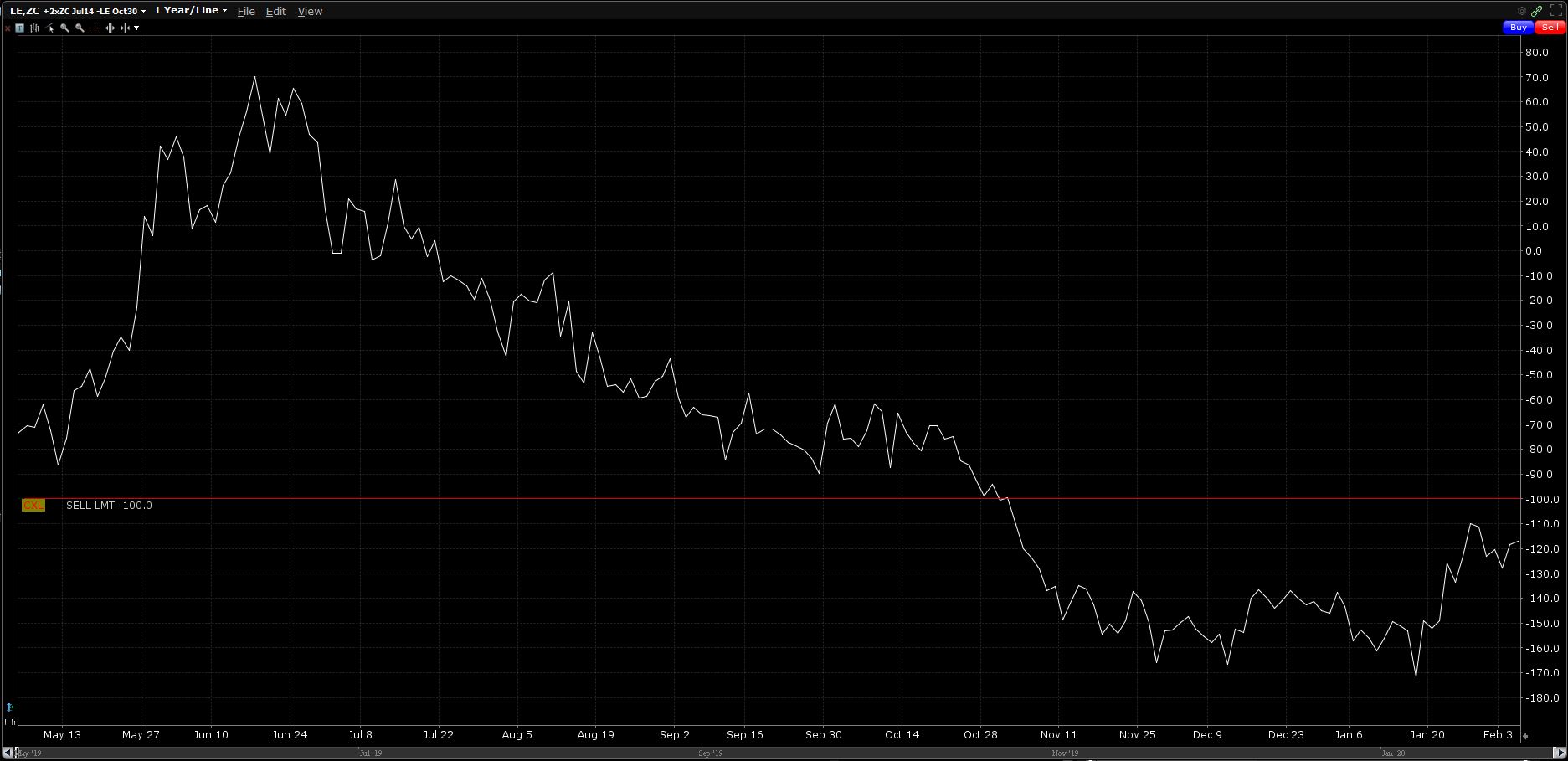

This is what I get:
http://www.sierrachart.com/image.php?Image=1580932456202.png
What we should be getting is a price trend like the attached, which is taken from IB directly from the very same symbols.
If I correct the spread definition, adding the multipliers, in IB symbol name format like so:
2*{ZC-202007-ECBOT-USD-5000}-{LE-202010-GLOBEX-USD-40000}
... but get nothing
The same has happened with many other custom symbols I've created
Please advise
imageZC_LE_Spread.JPG / V - Attached On 2020-02-05 19:47:44 UTC - Size: 175.82 KB - 396 views
[2020-02-07 08:21:45]
If you do the math you can see that the result is absolutely correct based on the formula. It does not matter what the interactive brokers chart shows, that is irrelevant.
