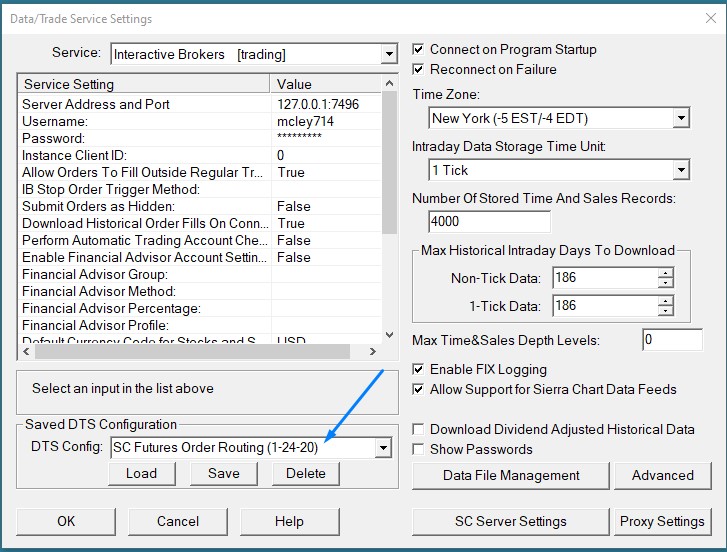

Can you tell where this configuration file (SC Futures Order Routing (1-24-20) is saved?
imageDTS Config.jpg / V - Attached On 2020-01-29 22:37:21 UTC - Size: 131.67 KB - 469 views

This is in the Accounts.config file.
