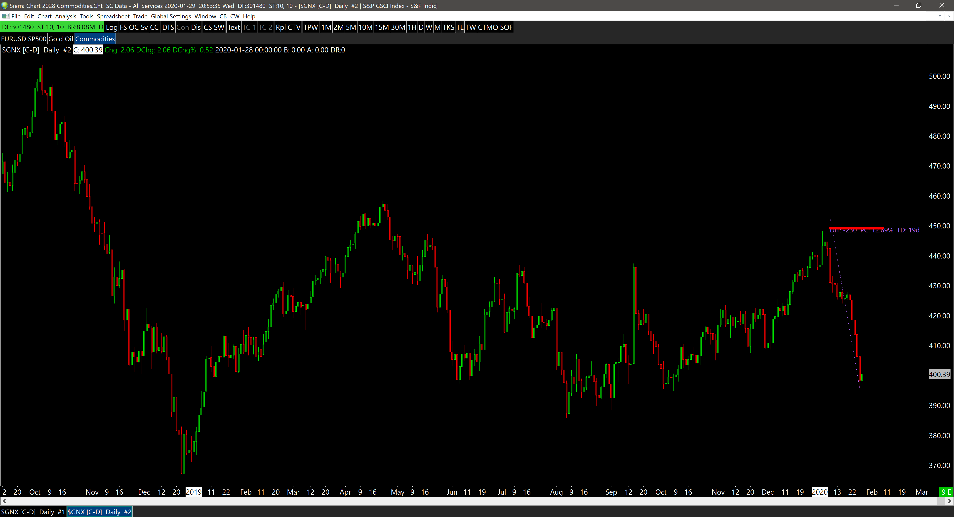

Chris32 - Posts: 81
It is not only this chart calculator on that particular chart, it is the same everywhere I have used it.
The red zone on the annotated copy is the part of the label that responds to clicking. The rest doesn't.
http://www.sierrachart.com/image.php?Image=1580324332744.png
imageImage [2].png / V - Attached On 2020-01-29 19:05:02 UTC - Size: 540.69 KB - 419 views

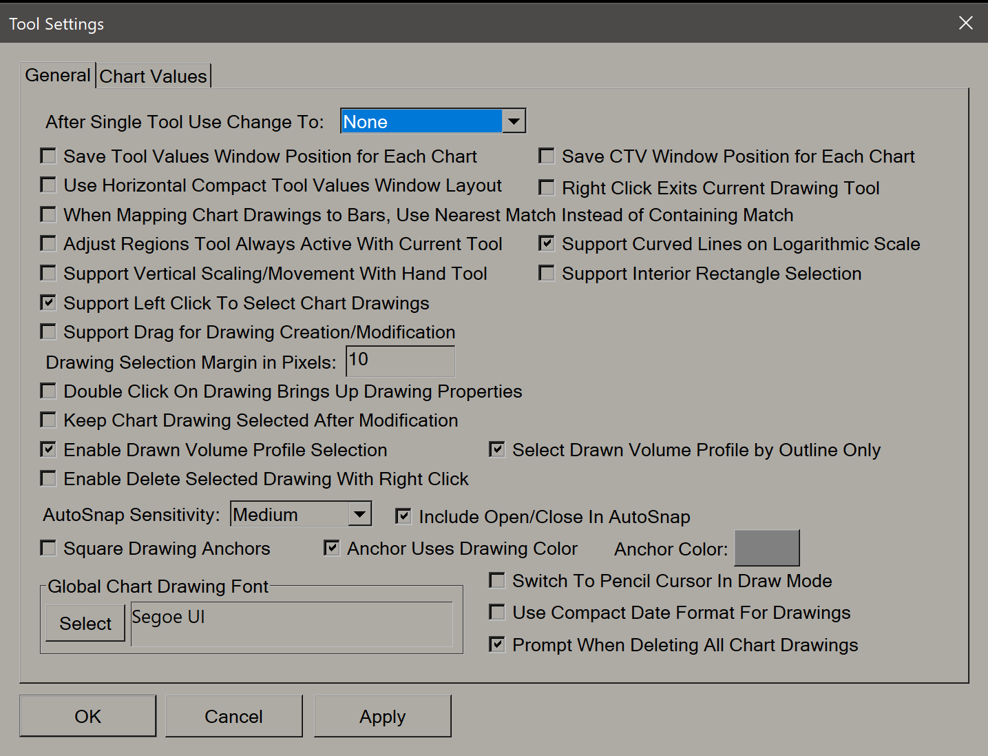

Can you attach an image of your Tool Settings?
Needing to click twice is normal functioning unless you have the option for Support Drag for Drawing Creation/Modification enabled. But you should not need to click in the same place.
So far, we have been unable to reproduce what you are seeing.

Chris32 - Posts: 81
Here is a screenshot of my Tool Settings.
Besides I have tried the following :
Install a second copy of SC on the same PC
Copy the my original SC folder to a windows 10 VM in Parallels on another computer (macbook pro)
Run it on another PC
I get the same thing in all cases, so it is weird you cannot reproduce it.
imageScreenClip.png / V - Attached On 2020-02-01 16:51:07 UTC - Size: 88.6 KB - 432 views
