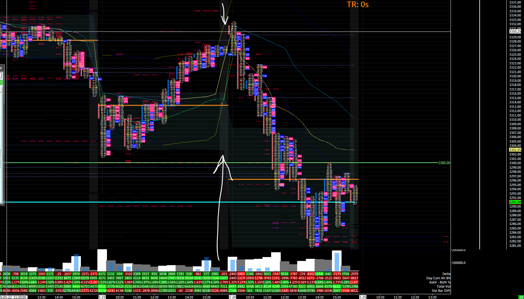

It's really irritating to look at and makes my chart feel very claustrophobic... how do I make these lines - VWAP and a study overlay of a keltner channel, as well as TPO value area lines specifically, start and stop at the beginning and end of the session without that annoying connecting line between sessions?
i've accomplished this with POC for the TPO value area lines, but when i set the Value area high and low to transparent fill top/bottom, it resulted in the value areas from the current day and previous day to be connected. all of the lines im referring to are within the grey column for the maintenance period. thanks.

This is not exactly what you are looking for, but this is the general solution:
Chart Studies: Avoiding Vertical Joining Line for Study Subgraphs

thanks, but that doesn't help me, unless there is a way to use the dash draw style and also have a fill top/bottom option. any thing else?

Use these Draw Styles:
Chart Studies: Fill Rectangle Top (ACSIL: DRAWSTYLE_FILL_RECTANGLE_TOP) and Fill Rectangle Bottom (ACSIL: DRAWSTYLE_FILL_RECTANGLE_BOTTOM)
