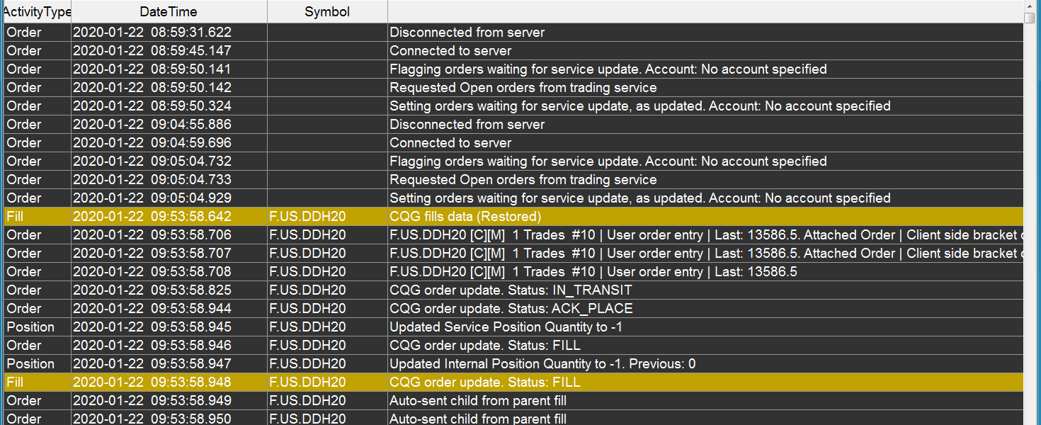

Dear support,
today I received CQG fills restored for trades that were already in my trade activity logs producing a double fill in the stats
image2020-01-22 12_32_07-Trade Activity Log.png / V - Attached On 2020-01-22 11:34:16 UTC - Size: 78.58 KB - 379 views

Check the Fill Execution Service ID field for those fills and see if they are different or the same. Let us know.
For now just simply select that duplicate fill and delete it through the Edit menu.
Date Time Of Last Edit: 2020-01-22 12:09:22
[2020-01-22 12:42:24]
caligola - Posts: 116
They are the same, so it should be a bug

Hi, it happened again today on SC 2038, same dynamic, already checked Fill Execution Service ID
Normal trading activity, I am not able to give you any hint
