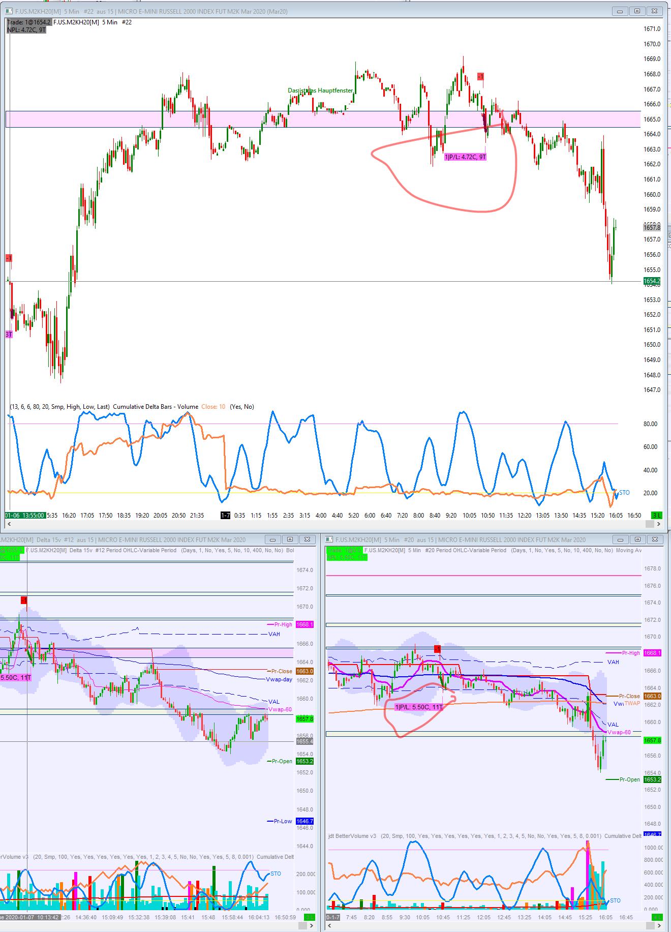

I have a problem with the correct result display
Although I entered the commission in Global, Symbol Settings, the result is displayed differently:
- once without commission
- once on commission
What do I have to do to make sure that the result (as entered in the Settings icon) is displayed correctly.
image####1.jpg / V - Attached On 2020-01-07 15:13:45 UTC - Size: 299.48 KB - 434 views

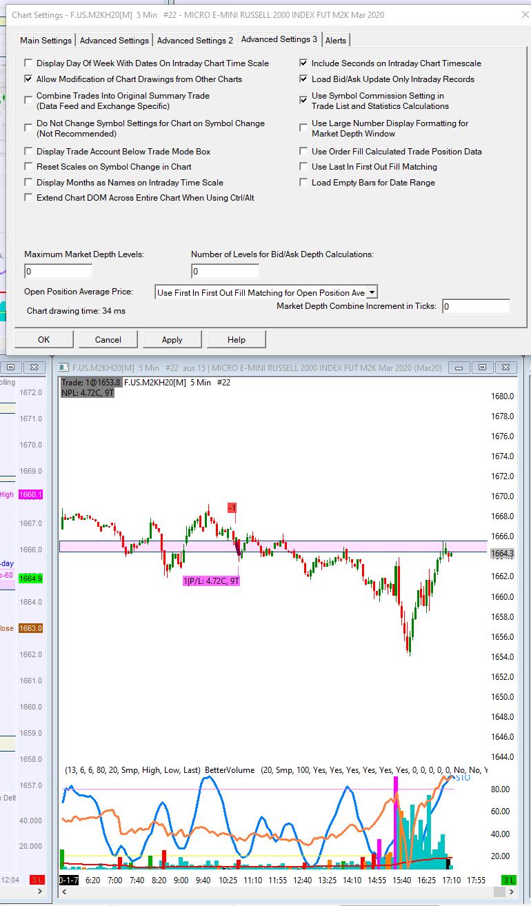

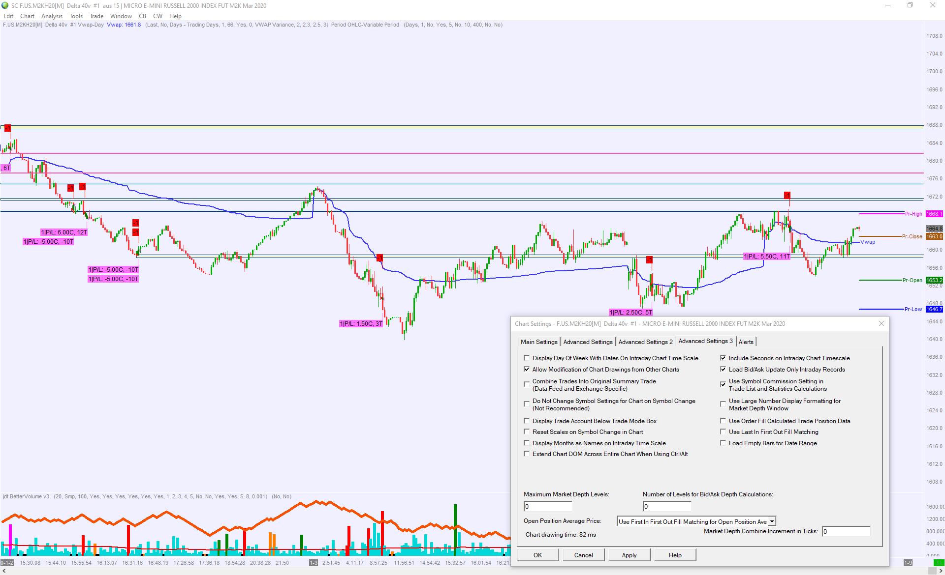

User912405 - Posts: 14
I have here the instrument M2KH20.
For this I have entered a commission of 0.78 in Global Settings / Symbol settings.
nevertheless I get different P/L - displays for the same trade and in the same chartbook.
- once 11T (wrong, because the commission was not considered)
- once 9Ts (correct because the commission was deducted correctly)
image####.jpg / V - Attached On 2020-01-07 16:12:21 UTC - Size: 238.08 KB - 456 views
image####1.jpg / V - Attached On 2020-01-07 16:12:36 UTC - Size: 148.47 KB - 414 views
[2020-01-07 19:09:44]
Make sure the starting Date-Time of the Trades list is identical for both of those charts:
Trade Activity Log: Understanding and Setting the Start Date-Time for a Trades List
