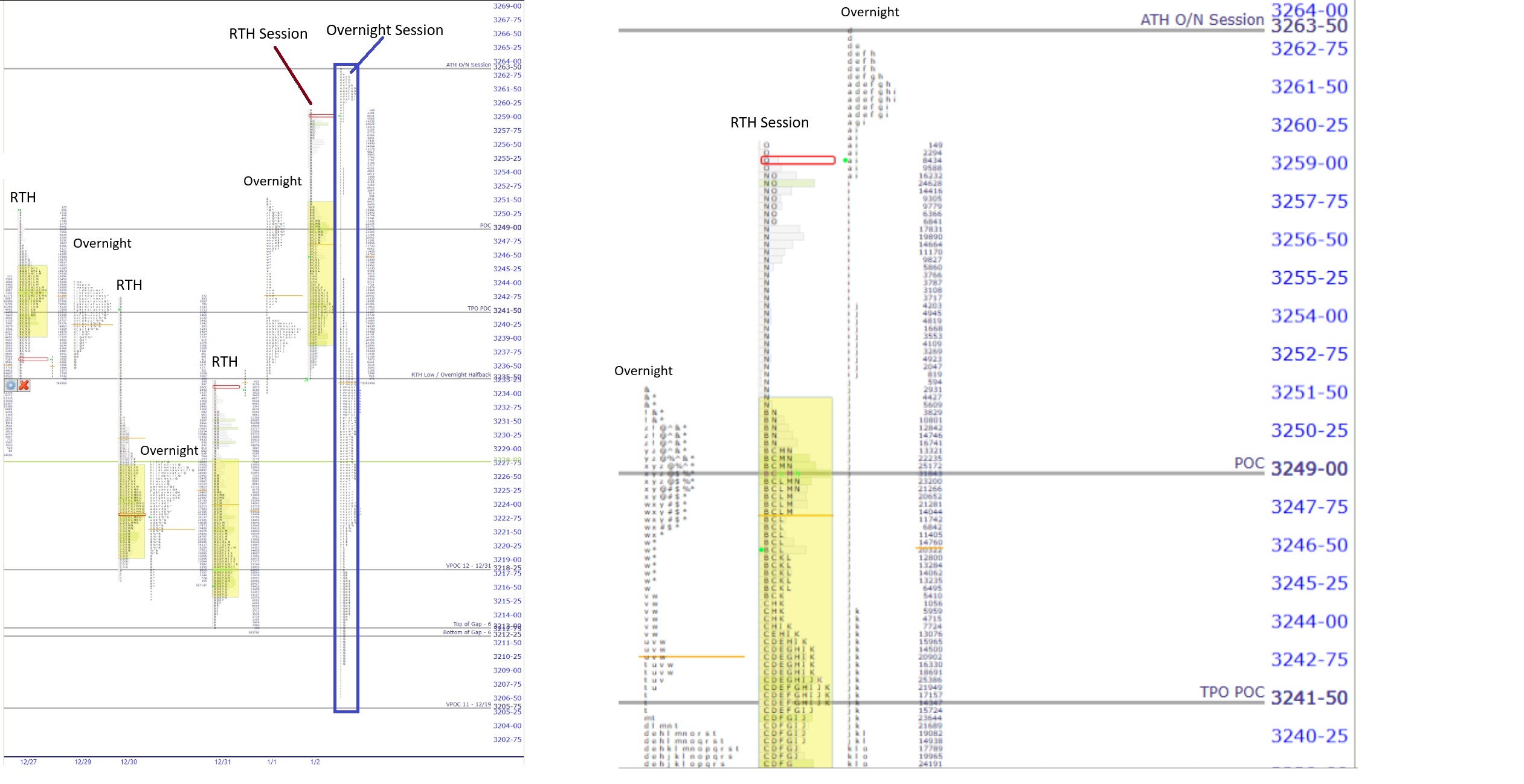

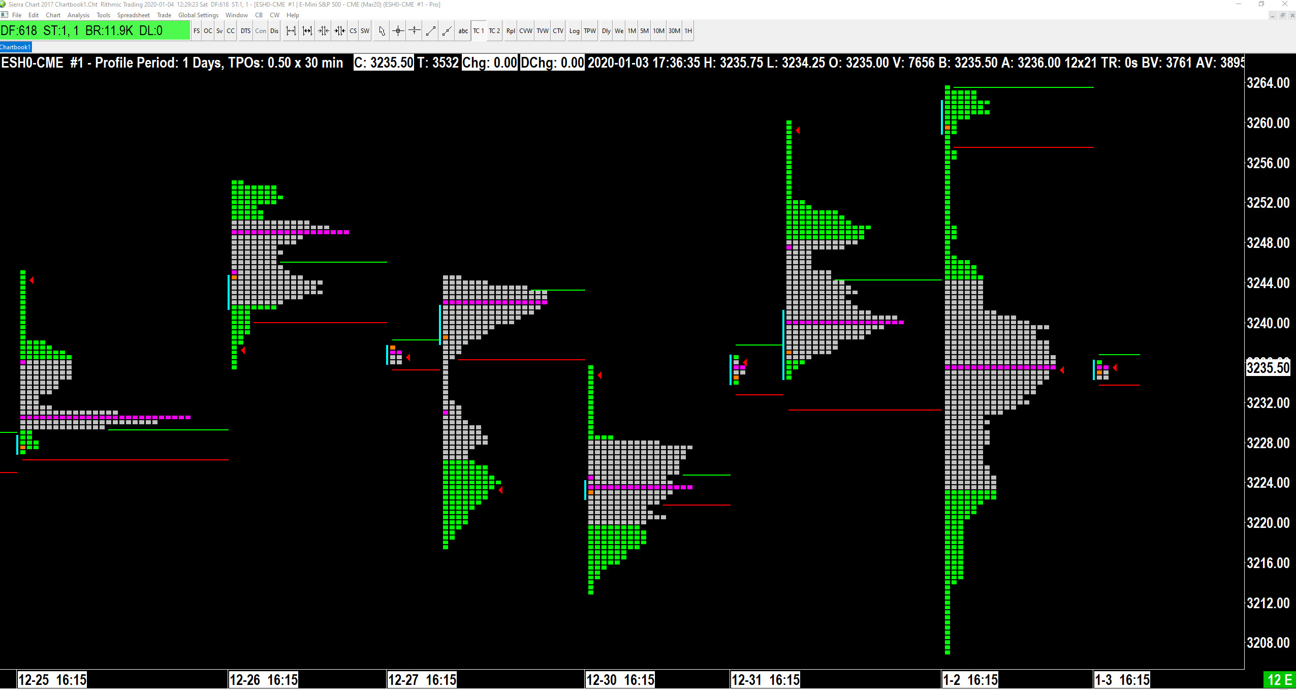

On Time Price Opportunity (TPO) Profile Charts - how do you change the settings to create separate profiles for the RTH session and overnight session?
Please see the 2 attachments that show the profiles of the last several sessions on ES
one attachment is a screenshot from another company that has the profiles on the RTH and Overnight sessions separate one after the other
the other attachment is a screenshot on the profiles as how they appear on Sierra chart on the default settings which looks like the RTH and overnight sessions are combined into one profile
How do I change the settings so that it will be more like the 1st attachment where the RTH session and the overnight session are separated?

[2020-01-04 17:59:40]
Profile Trader - Posts: 182
You will need to go into chart settings and setup for session times
Start 09:30:00
End 16:14:59
Evening Start 16:15:00
Evening End 09:29:59
You can then check or uncheck the Use Evening Session or use Ctrl G to swap between seeing it or not.
Hope that helps.

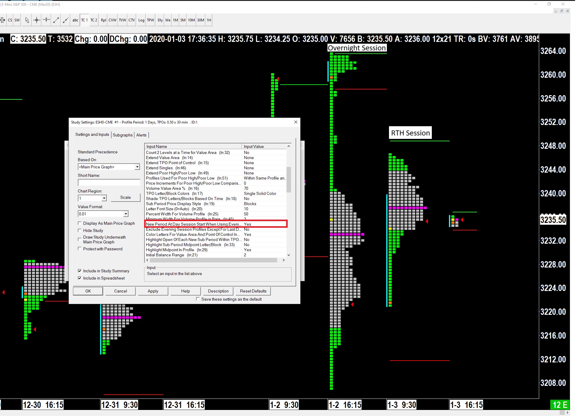

Jay Greenlees - Posts: 15
Hi--I think I found the correct setting to change
Adjusted setting on Sierra for New Period at Day Session Start
Now it shows both sessions (RTH and Overnight)side by side as separate profiles

John - SC Support - Posts: 48095
Yes, that is the correct setting to have a separate TPO for the evening session, assuming that your Session Times are setup properly. For reference, you will find the documentation for that setting here:
Time Price Opportunity (TPO) Profile Charts: New Period at Day Session Start When Using Evening Session (1 Day Period Only)
