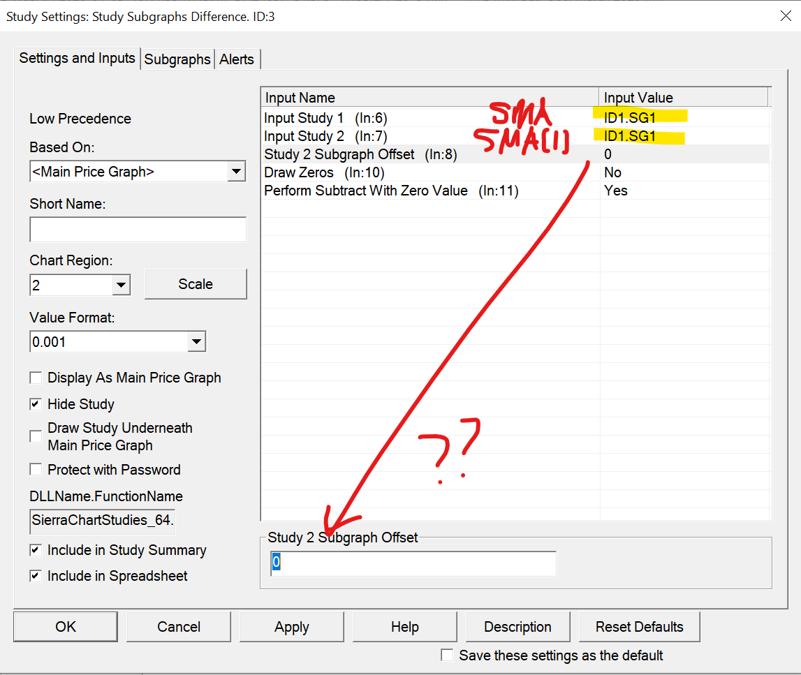

sourdubber - Posts: 52
Thanks for the pointer. It looks easy but I've already run into a problem. I am using the Study Subgraphs Subtract Difference to subtract SMA - SMA[1]. But how can I insert the offset of SMA[1] (ie. SMA one bar ago)? There is the offset option but I only want to apply the offset to one of the SMA, not both. Please click the link to see the image.

Ackin - Posts: 1865
Offset value - This is always converted to a positive value and is the number of bars back
Date Time Of Last Edit: 2020-01-04 03:49:26
[2020-01-04 03:53:30]
So going back to the example of "SMA - SMA[1]", do I need to create two different studies? I tried to create one study with just SMA and another with the offset of 1 (SMA[1]). But I didn't see any parameter setting for the offset. How would I plot, say, "close x bar(s) ago"?
BTW Is there not a way to plot the spreadsheet formula (for example, the one that wrote above) directly on the chart?
Thanks.
[2020-01-04 04:15:46]
Ackin - Posts: 1865
No... the inputs can be the same they are two different storages
Descriptions for this study:
Study Subgraphs Subtract/Difference
The values from input 1 are stored in array1
The values from input 2 are stored in array2
result = array1[current bar] - array2[current bar - offset]

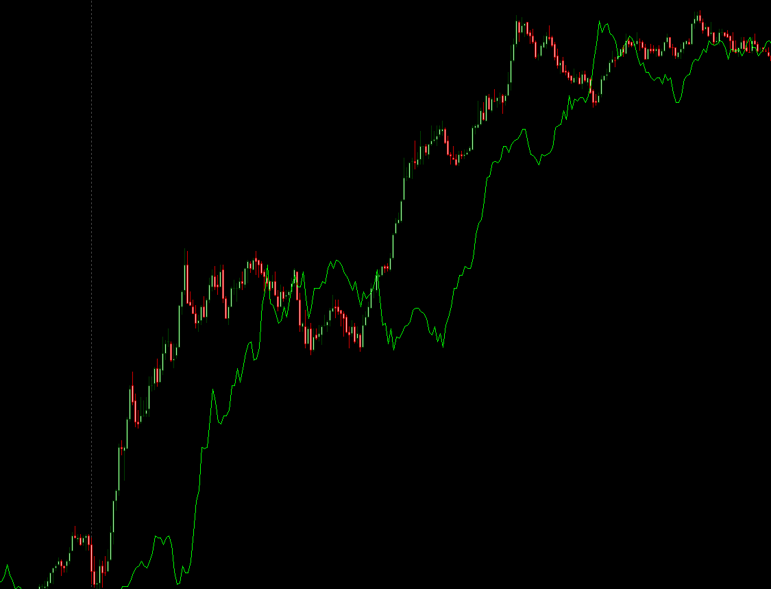

btw.
look on attached file, I did this as universal solution for: Referencing prior bars in Studies
