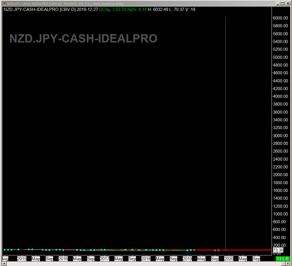

there's a huge spike in the nzdjpy historical data (daily++), see screenshot
imageksnip_20191229-072533.png / V - Attached On 2019-12-29 12:26:59 UTC - Size: 58.12 KB - 415 views

That data is from Interactive Brokers. Refer to:
Data Errors or Spikes in Charts, Flat or Flat Line Graph, Compressed Graph, Errors with Date/Time Values: 2.2 Historical Charts
We have also fully removed all use of Sierra Chart data for IB Forex symbols. This feature is now permanently gone.
Instead you need to use this method here:
Interactive Brokers Trading Service: Using Sierra Chart Historical and Real-time Forex Data and Trade through Interactive Brokers Account
