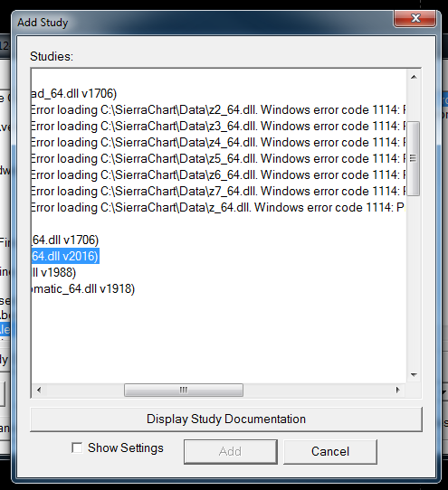

No, if I currently copy 3 times more libraries to DATA folder than I have, I see the same issue. Some libraries won't be there. Do you want a screen? :) SCH 2017 64-bit
EDIT: My test now -> after 60 custom files every other new one automatically shows an error code 1114
I attach the "Add Custom study" tab screen
I don't report this to you as a bug, I just wrote to the author of the topic if he doesn't have many files there.
Personally, I think that 60 custom files as a limit (for me, in other pc the number may be different) is more than sufficient...

imageerror code 1114.png / V - Attached On 2019-12-24 01:49:12 UTC - Size: 43.15 KB - 454 views
