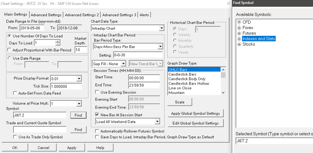

I attached a file showing that I don't have the "market stats" dropdown item. This is why I thought I may need to run another copy
imageSC Data.jpg / V - Attached On 2019-12-06 16:51:57 UTC - Size: 123.07 KB - 401 views
[2019-12-06 17:25:22]
This is because you are still using IQ Feed. So these Sierra Chart market stats are not listed when using IQ Feed so you do not get confused between our statistics and IQ market statistics.
In this particular case you can install another copy of Sierra Chart and access the SC market stats that way. Refer to:
Using Multiple Data and Trading Services at the Same Time: Step-By-Step Instructions to Install Multiple Copies of Sierra Chart
Date Time Of Last Edit: 2019-12-06 22:56:52
