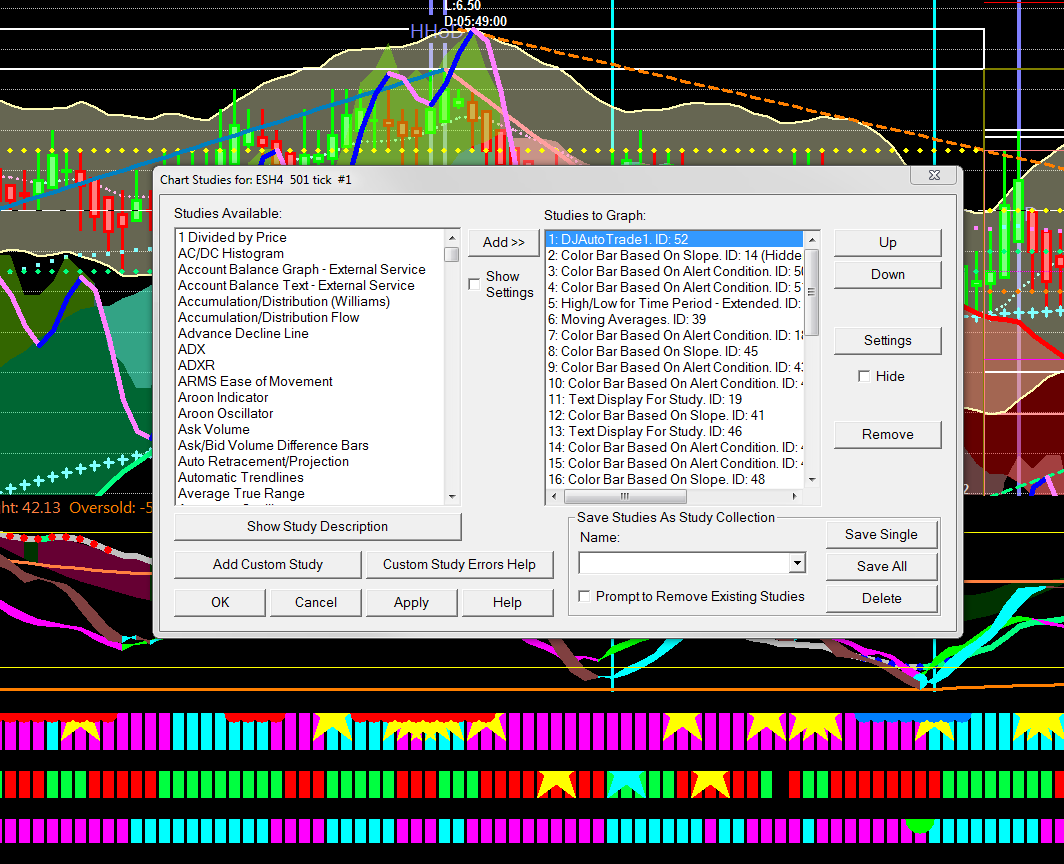

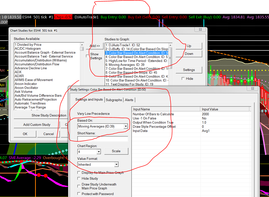

djcurcio - Posts: 236
Screen shots enclosed.
First is the "SC speadsht studies before" file. It shows the studies before I add the short name.
Next is the "SC Spreadsheet name added in first not second line" file. It shows that the short name got added to the first line, not the second line of the spreadsheet.
Next the third file "SC Chart Studies Settings now corrupted not color bar highlighed but Moving averages in child window" shows the corrupted names in the Chart Studies window. Notice that "Color Bar Based on alert" is selected but the Moving Averages study appears in the child window.
