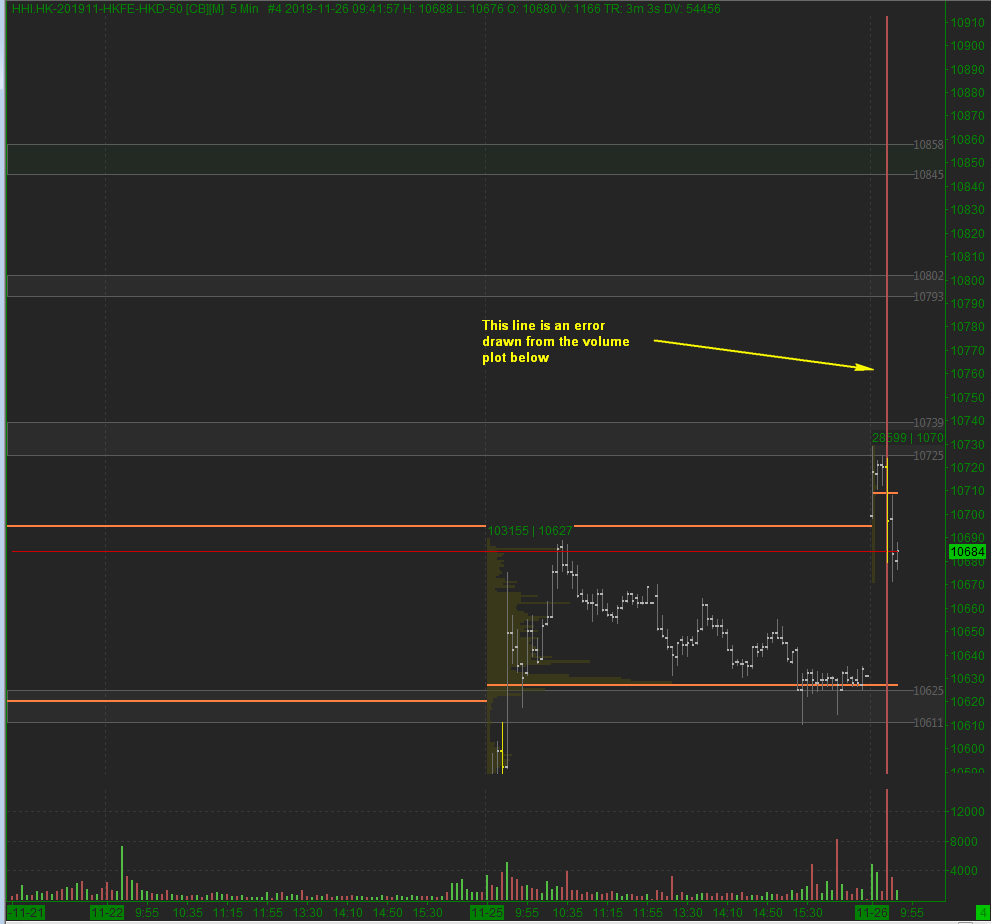

I don't know how else to describe this. Has happened several times in the past and starting to become annoying. Please see the attached image highlighting the issue.
imageMK-2019-11-26_144237.png / V - Attached On 2019-11-26 01:44:31 UTC - Size: 27.45 KB - 397 views

We do not see how that is technically possible, duplicate that chart (Chart >> Duplicate Chart) and remove all other studies, and see if you still notice this.

I did this several times. Removing studies seems to make this anomaly go away, but I do not find the reason for it to go away to be consistent, ie, the same study removed from one instance to another does not consistently make the anomaly go away.

Technically, this is possible because it is happening sometimes. Do you have any suggestions other than removing all my studies and tediously re-adding them all?

Provide us that particular chart and we will test it. Here are instructions:

Its easier just to give you the "production" chartbook because it has studies that depend on other charts. The recent problem shows up 2 days ago on the 5 minute chart.

What you are seeing is drawn by one of the studies in particular study with ID 3 on chart number 4. Why do you have that? Just remove it.
