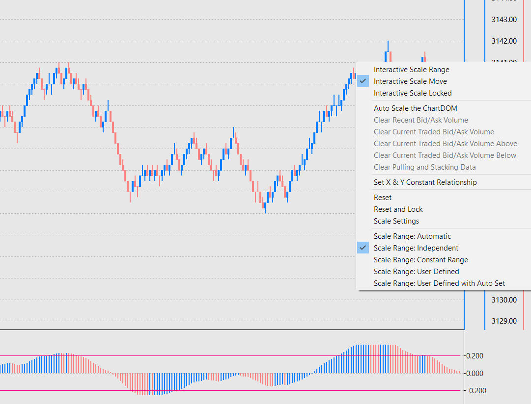

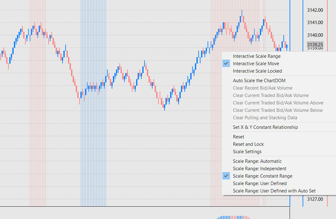

Indicators and a table have been added to the e-mini SnP 500 chart. The table contains the trading system. The system opens trades (candles with large points), marks potential areas for entry (vertical lines of blue and red), marks candles with the lowest probability for entry. There are no questions to the first chart.

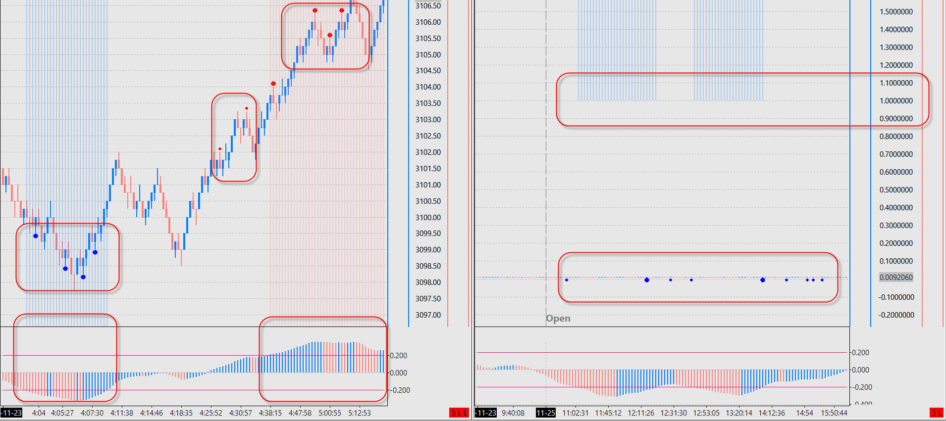

I try to add the second chart (duplication) in the same table on the second sheet with the same algorithm of work. The second chart shows Japanese Yen (the chart is compressed to show vertical lines). Signals (big and small dots) are visible on the chart but vertical lines of blue and red are not visible. Rather, they are displayed but above the price values of 1.0000000. Japanese Yen has no such prices.
Question: why is this happening? why are vertical lines not displayed in the price area (on bars)?
Hi, As output you have set logic "0" and "1" somewhere, you should have output there as a real value of bars. Check trading system / studies outputs (its setting output values)

According to screen no.112 you can see that you ask somewhere about the logical condition IF..THEN..TRUE / FALSE and then you take the result and use it as a value for Drawstyle (so you have a value of 1.0 as the dividing line, number one is "Logical TRUE"). The TRUE condition must result in a "Last Close" or other value corresponding to the candles values ​​(Close,High,Low,OHLC,HLC etc.)

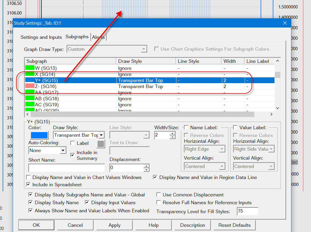

where the Spreadsheet System/Alert for Trading table defines the price range (above 0/ below 0) in which the Transparent Bar Top style is displayed for the logical expression =AND (AD3<-0.2)

2garin - Posts: 189
pay attention

User907968 - Posts: 884
Did you read the instructions regarding these draw styles?
Chart Studies: Transparent Bar Top (ACSIL: DRAWSTYLE_TRANSPARENT_BAR_TOP) and Transparent Bar Bottom (ACSIL: DRAWSTYLE_TRANSPARENT_BAR_BOTTOM)
