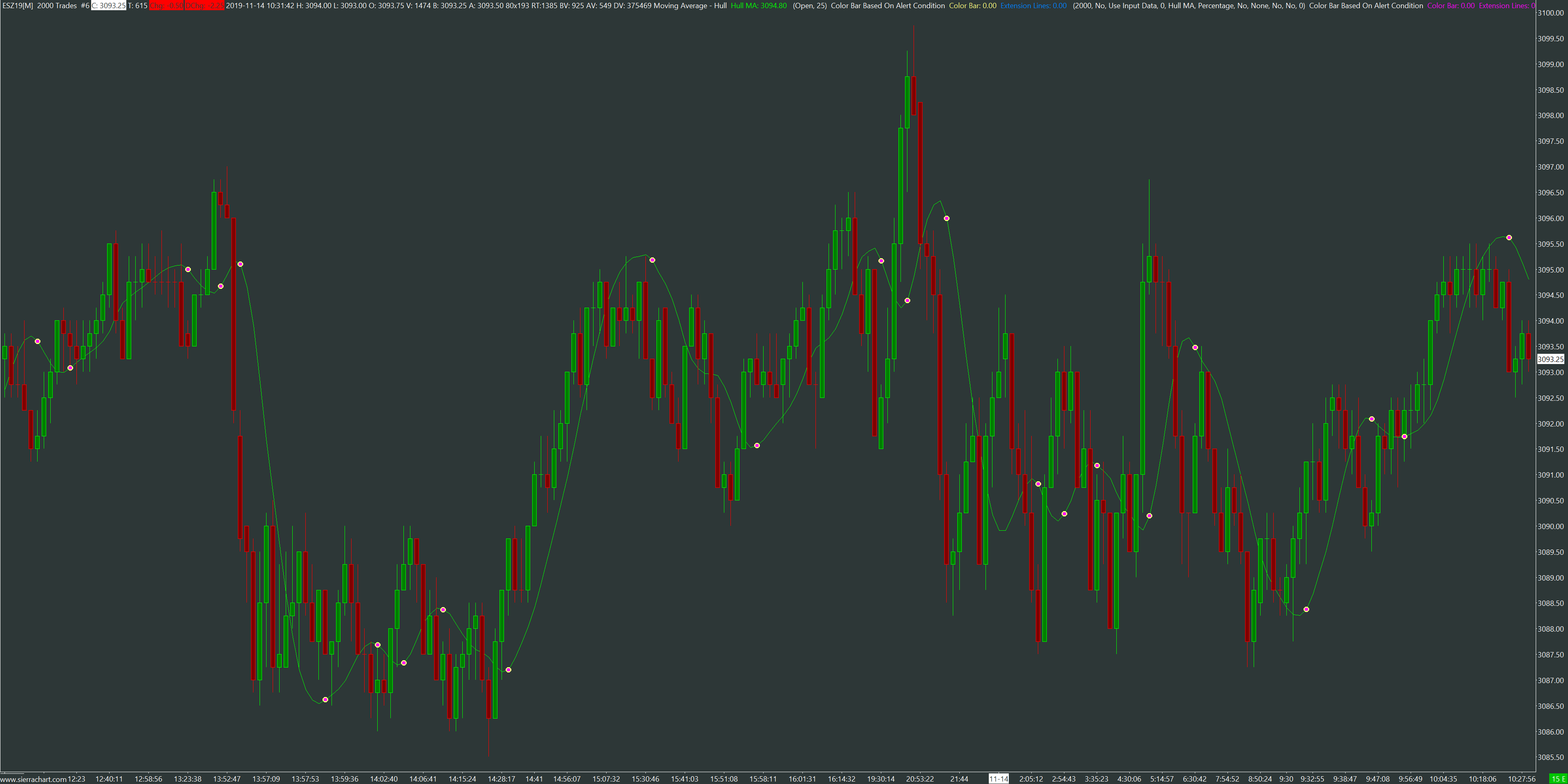

Trying to have the hull change colors when bullish (green) vs. bearish (red). From what I get, I would use the Color Bar Based on Alert Condition study.
I used formula #8 from the list of alert formula examples on Study/Chart Alerts And Scanning: Alert Formula Examples
I added the Id number of my hull study (6) so the formula came out as follows: =OR(AND(ID6.SG1[0] > ID6.SG1[-1],ID6.SG1[-1] < ID6.SG1[-2]), AND(ID6.SG1[0] < ID6.SG1[-1],ID6.SG1[-1] > ID6.SG1[-2]))
Finally, I changed the draw style of SG1 to Line-skip Zeros to no avail.
http://www.sierrachart.com/image.php?Image=1573745504544.png

tomgilb wrote How, Look at:
HULL-ALERTS | Post: 197476

User415649 - Posts: 9
I tried this, it didn't work for me. The whole chart would turn into to one thin line, candles and all.
[2024-01-19 18:04:12]
In general, refer to the following:
Chart Studies: Preventing Study From Compressing Main Price Graph
But it doesn't make any sense how the "Moving Average - Hull" can cause this, given that it should not have a very different range of prices.
