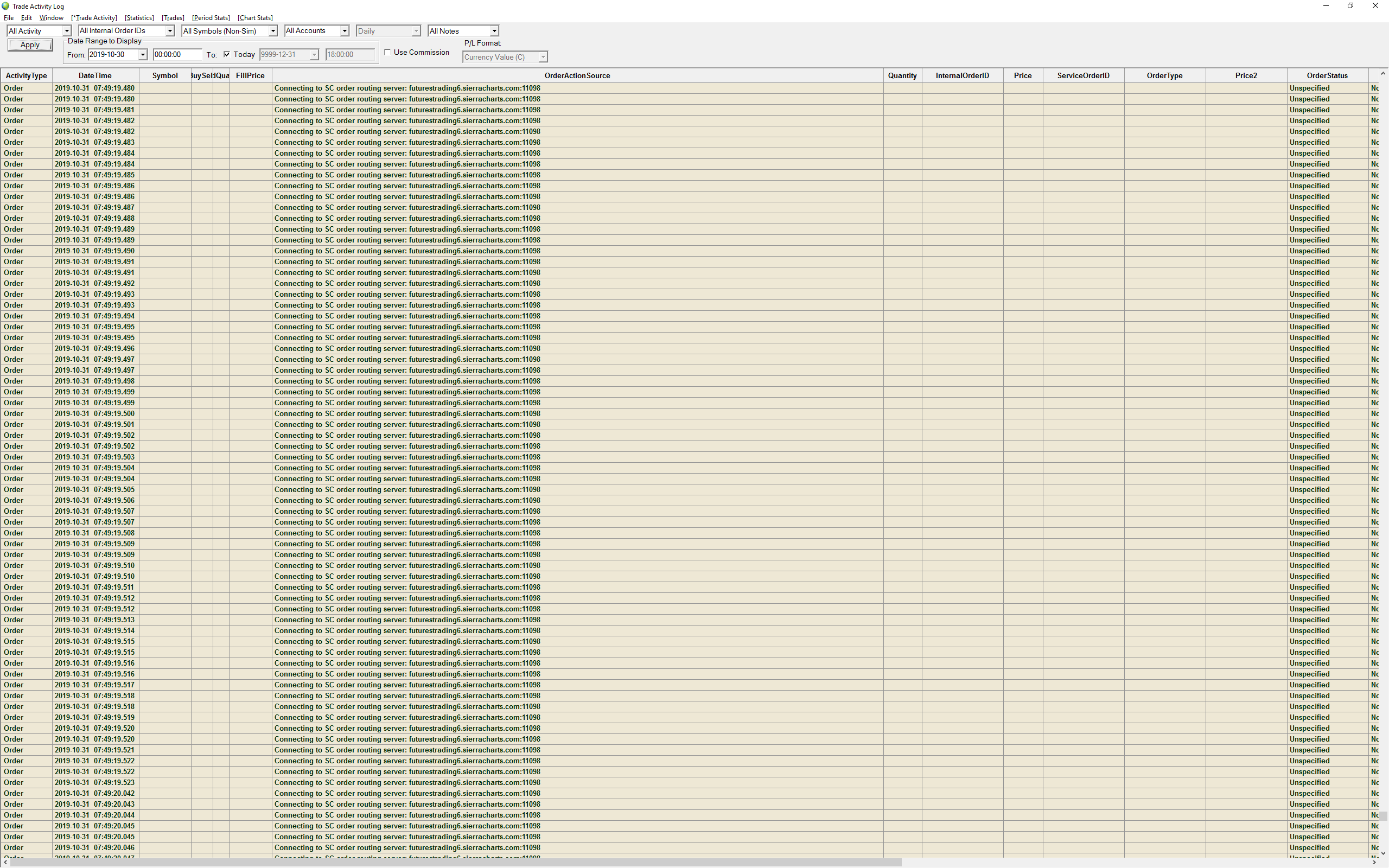

"Connecting to SC order routing server: futurestrading6.sierracharts.com:11098" appears in the trade activity log 1-2x per millisecond.
I assume this is going to use a lot of resources on operations which process the log.
Is there a way for me to remove these entries/clear the log while keeping my fill data?
image10014-2019-10-31-1302.png / V - Attached On 2019-10-31 13:04:26 UTC - Size: 297.67 KB - 390 views
[2019-10-31 14:01:20]
Ok, that is completely unexpected. That is the address of the London server but there should not be any repetitive messages like that. Can we call you now? This is considered a serious issue.

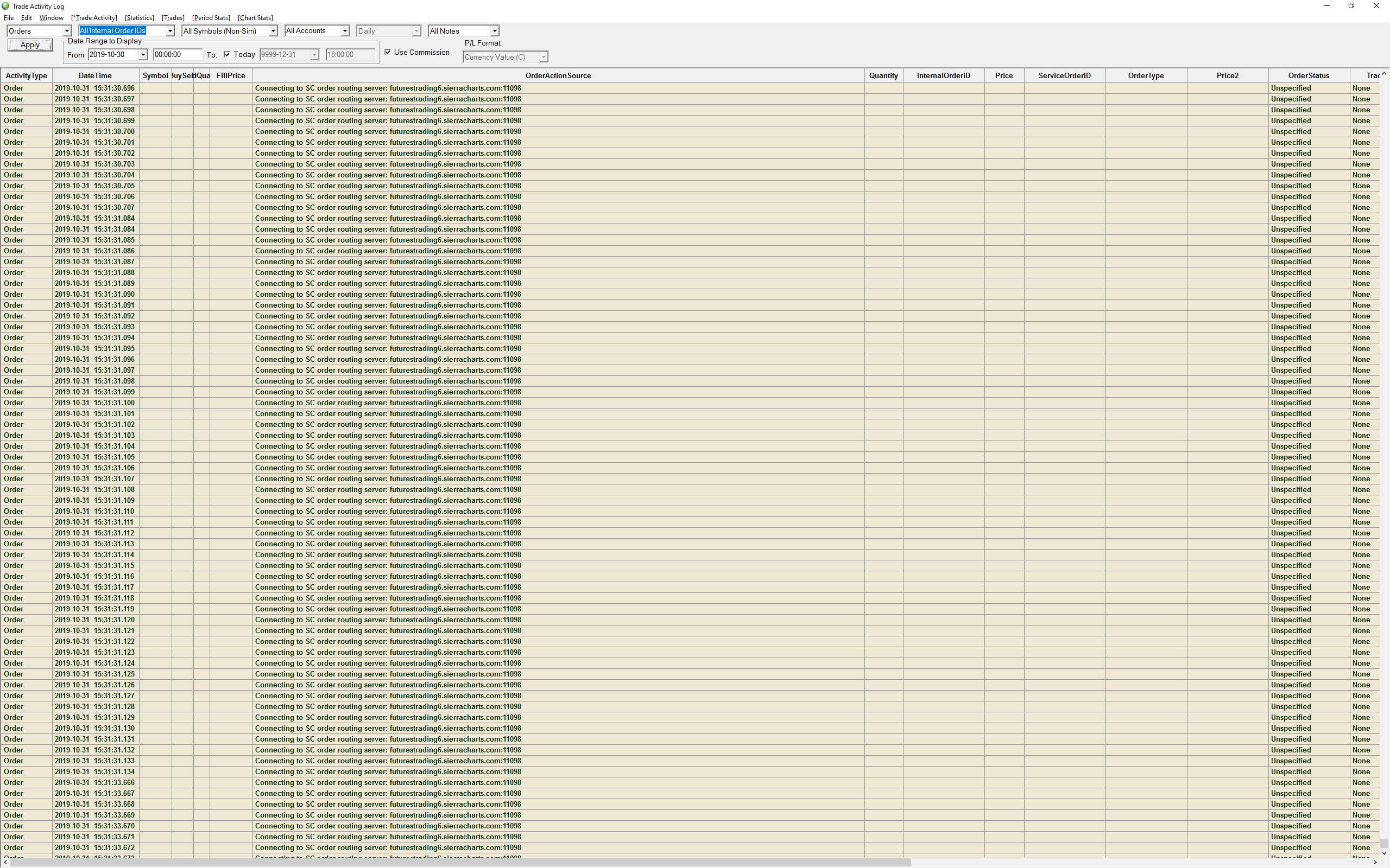

And I can confirm the issue is still occurring with version 2006.
Date Time Of Last Edit: 2019-10-31 20:33:40
image10025-2019-10-31-2033.png / V - Attached On 2019-10-31 20:33:21 UTC - Size: 298.14 KB - 372 views
