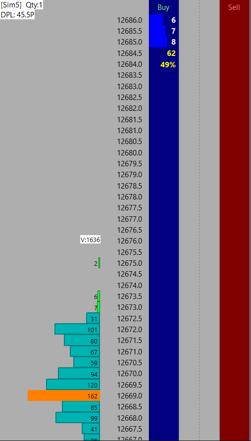

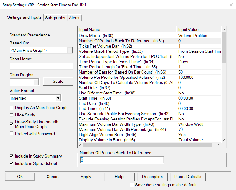

My VbP on the DOM is way below the actual trading prices. It is set to period "Session Start to End"
What could be possible causes for this? and what should I adjust to fix it?
please see attached images

Go to Chart >> Chart Settings for the Trading DOM and make sure the Session Times cover the full 24 hours and are correct:
Chart Session Times

[2019-10-21 09:01:35]
ycomp - Posts: 334
ah, they were but I forgot to use the correct time zone

[2019-10-21 10:04:52]
In the Volume by Price Input settings you can specify the session times that the calculation is performed for.
Date Time Of Last Edit: 2019-10-21 10:04:57
[2019-10-21 10:30:27]
ycomp - Posts: 334
thanks, but to clarify - using the settings above for the chart and VbP session start to end - when would the calculations start? 9:30? 9:30 and 16:15?
