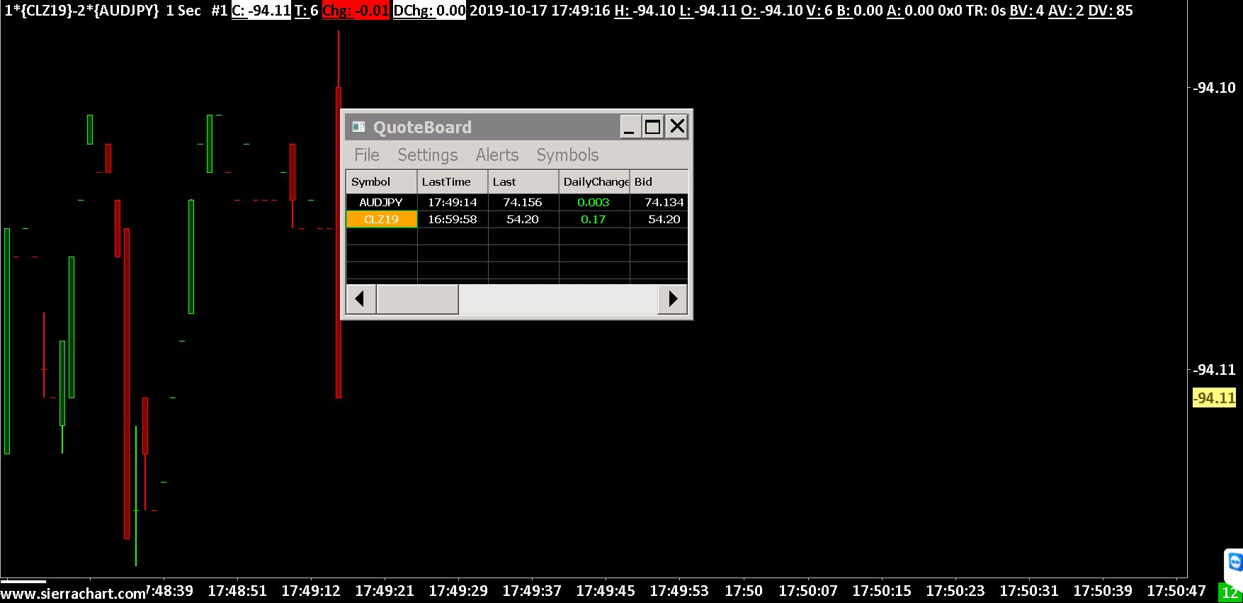

I have managed to work this out. There is still a problem. For example, I have created a custom symbol with following code 1*{CLZ19}-2*{AUDJPY}. This is showing value on chart currently of circa -387. CL is currently trading at 53.32 and AUDJPY at 73.534. Therefore, how do I get the custom symbol to show as trading at (1*53.32)-(2*73.534) = -93.748 on the chart. I just want to see the price differential between the two assets, given the multipliers I have stated.
Also, it does not seem to be showing any historical data, just the current bar? Any fix for this?
Thanks in advance

We went through the documentation step-by-step, and the symbol was listed in the File >> Find Symbol under Custom Symbols as was the recommended category.
We opened up an Intraday chart and the calculation is correct:
http://www.sierrachart.com/image.php?Image=1571348959172.png
We think the issue might have something to do with a problem with symbol character translation. Update to the latest prerelease following these instructions here:
Historical data support for times when not connected the data feed is coming. It is expected to be out before the end of the year.

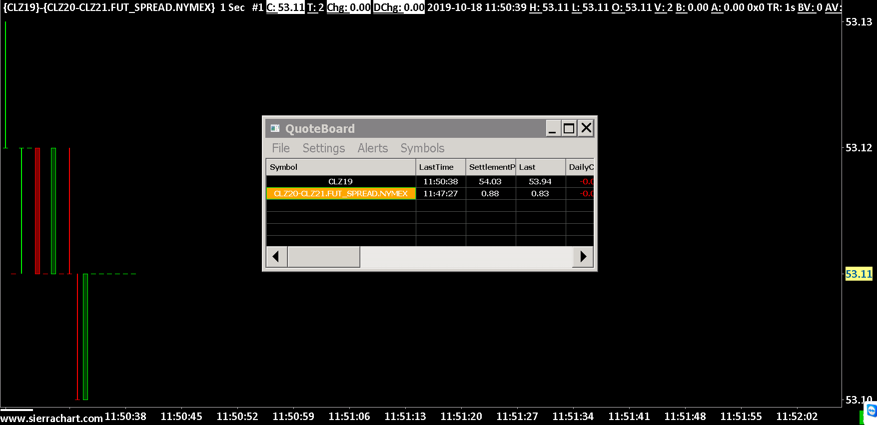

Try creating this custom symbol {CLZ19}-{CLZ20-CLZ21.FUT_SPREAD.NYMEX} - it gives you a negative value of around -31, this is wrong. Any solution?
Date Time Of Last Edit: 2019-10-18 14:35:39
[2019-10-18 16:00:00]
This will be resolved in the next release (out in a few days). It is because these spreads are transmitted in an unadjusted price format as the data comes from the exchange. So we needed to apply a price multiplier . This is now done:
http://www.sierrachart.com/image.php?Image=1571413839179.png
