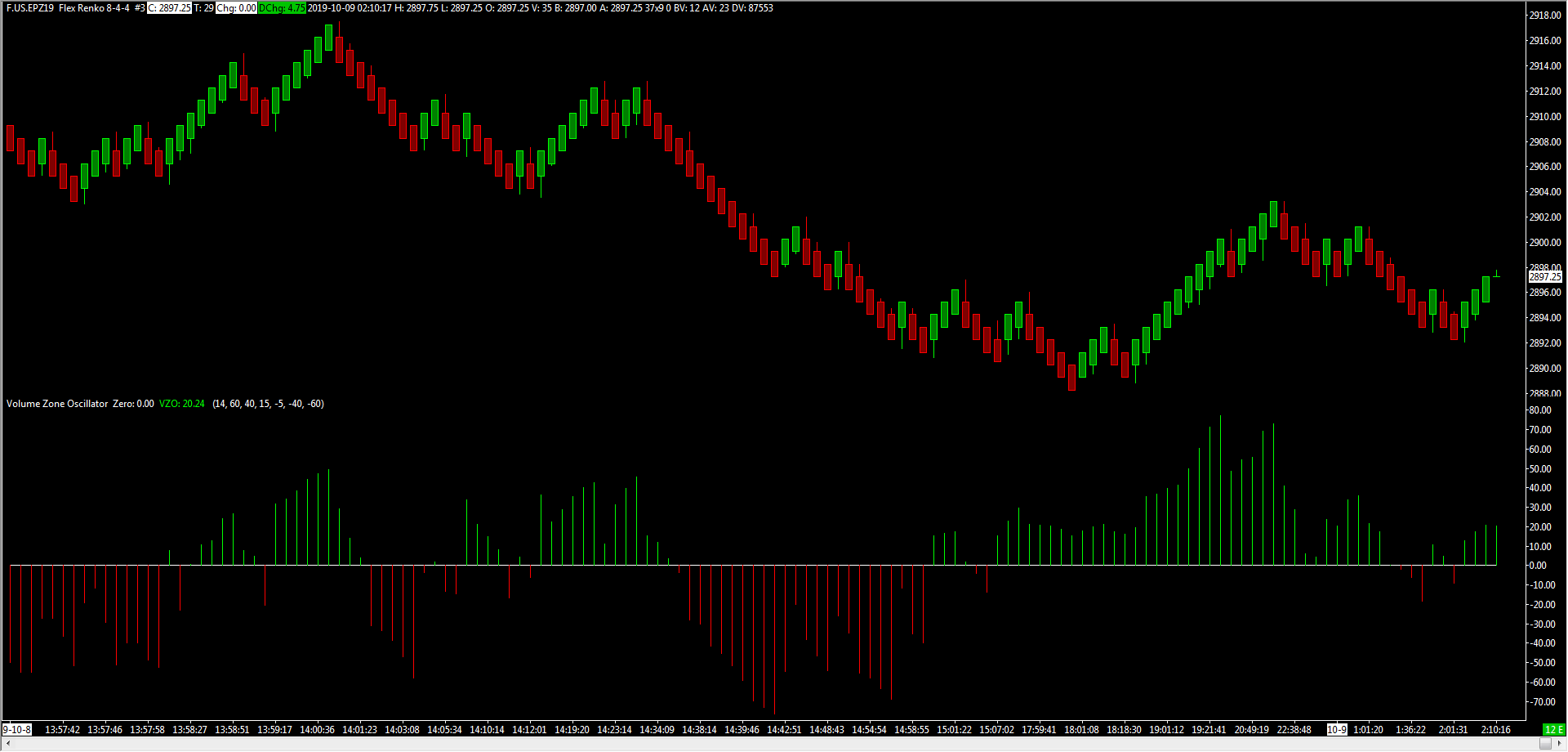

I want to start off by saying that sierra chart is my platform of choice. But I have tried every variation and customization that i could to get a correct subcharting visual of a Volume-Weighted Accummulation/Distribution graph that is similar to the picture i attached. If possible, can u add it?

We are not understanding this. That chart shows the Volume Zone Oscillator. Specifically what is the question in regards to it? Did you not make that chart yourself and you want the study to look like that? Or did you make it and therefore what is the question?
[2019-10-09 10:36:34]
Actually we see the study in the chart image is named "Volume Zone Oscillator Zero". The one in Sierra Chart is named "Volume Zone Oscillator".
Not sure of the difference. Maybe just the Draw Style is different?
Date Time Of Last Edit: 2019-10-09 10:37:06

I was using that particular graph in my attachment as a example of the visual that i cant create with a Volume Weighted A/D, because there is no Volume Weighted A/D study. And the Accumulation/Distribution studies that are available, they have a different charting visual, and when i tried to make them look similar to the graph that i posted, it simply doesnt allow me to. The ideal study that i dont have or see or can create is the Volume Weighted AD that plots a similar graph as the Volume Zone Oscillator that i manually adjusted for an example to show you all. I attached another picture of how it should look. Please help, and i am not savy enough to program it myself, if i could then i would.
