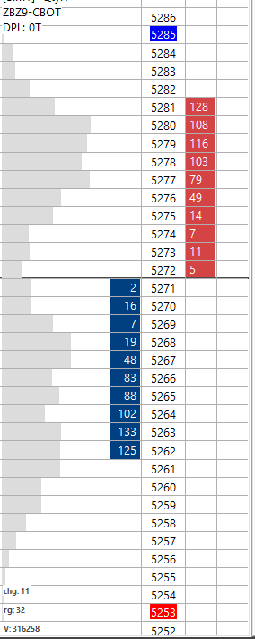

[2019-10-06 07:35:09]
archymede - Posts: 19
I would like to be able to see the net change in the Dom itself without having to press buttons and fiddle. You have no idea visually where the market is relative to the previous close unless you are looking at another chart or have a good memory:) Or you can have a quote board. TT CQG STS all display this.
Many thanks
This is really EASY to do using the spreadsheet study and text displays studies on the dom, there could be another way but here's how I do it :
1. add a spreadsheet to your dom
2. find or calculate the values you need and put them in the right columns (K, L and so on)
3. add the text display study and configure the settings to your need
Attached is an example of what can be done (blue and red prices are the high/low of the day, on the bottom you can see the daily change in ticks, the daily range and the volume)
imageexample.PNG / V - Attached On 2019-10-06 07:34:38 UTC - Size: 15.07 KB - 480 views
[2019-10-06 08:20:03]
Https://tradingbalance.co.uk - Posts: 44
That is perfect thank you so much Archymede.
