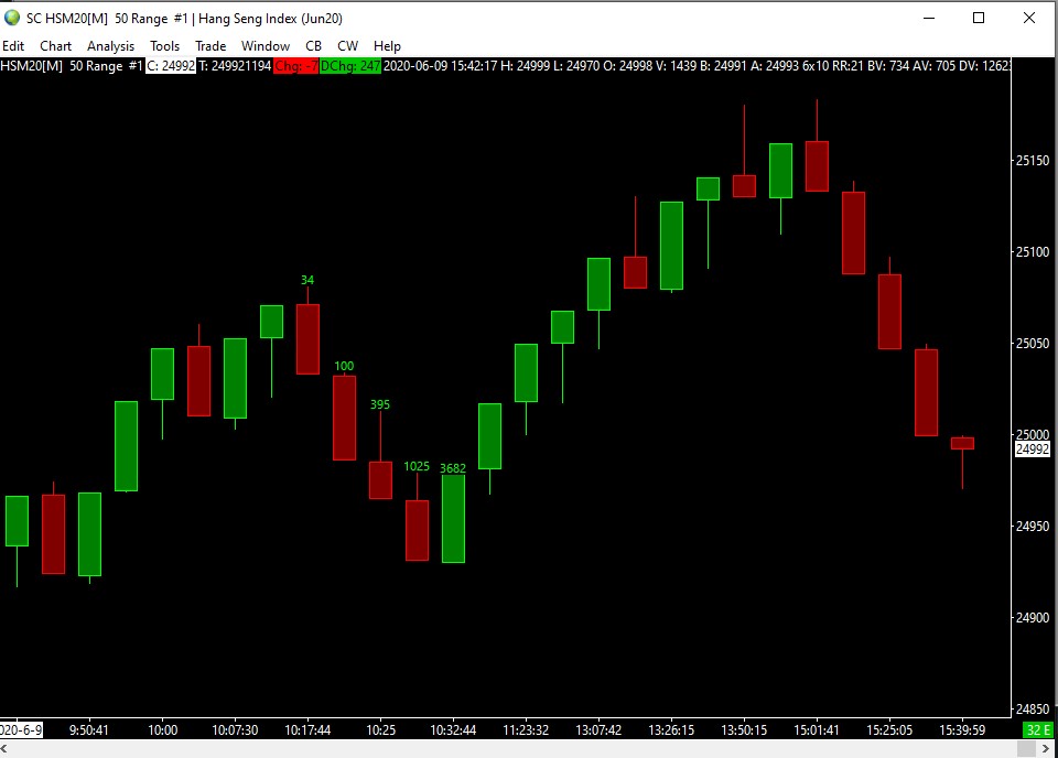

Hi, I have followed the given instructions. I duplicated a new chartbook but for some reason it is not in the data folder. I uploaded the original cht file instead.
As what you suggested, I've removed everything with only the TD study left. This is a 50 point range bar for HSI futures.
Everything's removed but as you see, the numbers can get up to 1000s.
Eric
imagetd.jpg / V - Attached On 2020-06-09 07:46:18 UTC - Size: 72.13 KB - 1050 views
imagestudies.jpg / V - Attached On 2020-06-09 07:46:24 UTC - Size: 138.05 KB - 861 views
attachmentChartbookExample.cht - Attached On 2020-06-09 07:46:51 UTC - Size: 20.65 KB - 697 views
[2020-06-10 19:15:57]
The chartbook you attached does not have the chart you show in the images and does not have the Trading the Nines study on it. We are unable to reproduce the issue you are having with the study and a range chart. Even for the same symbol (HSM20). Therefore, we really need that Chartbook with the chart so we can see if there is something about your setup that is creating this.
