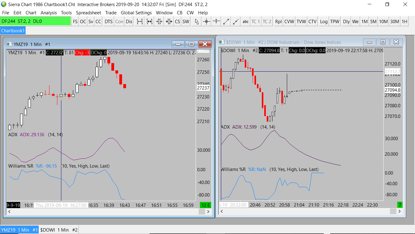

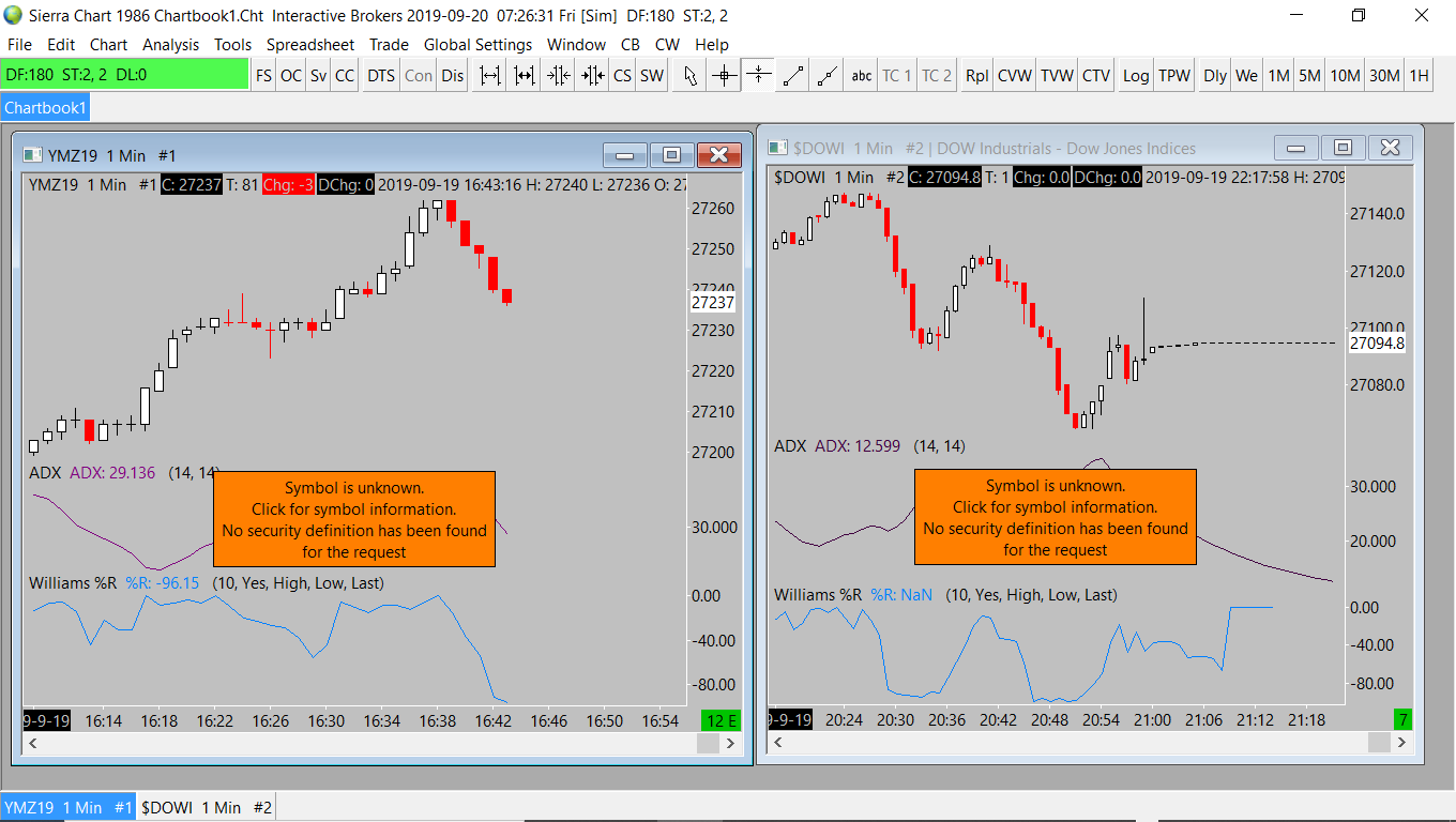

[2019-09-20 13:48:37]
User471007 - Posts: 7
Hello. I did as you advised. Waited for the market to open - and no live feed on the charts again.
Just to confirm, I do not want to trade from the Sierra Charts. I only want to view 2 charts (INDU which you stated is $DOWI and the YM). After viewing these charts I will place a trade with Interactive Brokers via an API called Bracket Trader.
Today, a box dialog appeared that stated the symbols were not recognised but this disappeared after a short while - not sure if that is helpful to you.
imageSierra Charts Symbol not recognised box appears on opening.png / V - Attached On 2019-09-20 13:40:26 UTC - Size: 71.56 KB - 429 views
imageSierra Charts - live feed not working at start of market 20 .png / V - Attached On 2019-09-20 13:40:48 UTC - Size: 66.94 KB - 408 views
[2019-09-20 14:00:47]
Select Edit >> Translate Symbols to Current Service.
We are going to activate the Dow Indices exchange for you now.
Please confirm when you are receiving the real-time data for both the cash and the futures.
Date Time Of Last Edit: 2019-09-20 14:17:33
[2019-09-20 17:04:47]
Hello. Thank you very much - I now have live feed for the Dow ($DOWI M). The YM however is still on yesterday's date so I think the symbol must be incorrect - currently it is YMZ19 there isn't an 'M' after it. At least we have half the problem sorted and for that I'm very grateful. Would you advise what might be the problem with the YM chart?
Thank you.
Rosemayre
[2019-09-20 17:20:53]
Did you select the Edit >> Translate Symbols to Current Service command?
[2019-09-20 18:49:44]
User called and issue resolved. We just had to use this menu command:
We also changed the color of the time and price boxes for the Chart Values tool.
