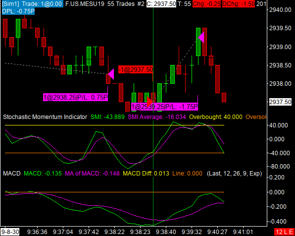

It's taking shorts and not necessarily at the crosses. See where I put the green line. See where the macd is still crossed down and the smi is crossed up. It took a short. They have to both cross in the same direction. Also i need to have it only go short when price is under vwap.
If 'Signal Only On Bar Close' is set to No, it's possible a short was signaled intrabar.
Also, using a range of 4 bars (AA3:AA6) might give unexpected results.
