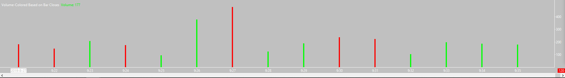

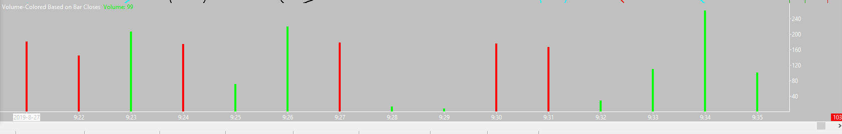

So, instead I simply took small screenshots and attached them to this and (due to the number being limited to 4 attachments) to the next message by means of the "add/edit attached files" option here.
All pics show the volume indicator chart region across a time window of (the same) few minutes for a 1 minute numbers bars chart and a 1 minute candlestick chart (both CLEV19).
For the two "...BEFORE recalculation" pictures, the last time I recalculated manually was at 09:25 chart time. You will see that both, the numbers bars and the candlestick charts show the same volume for the earlier few minutes shown. But from 09:26 on the volumes in both charts are vastly different.

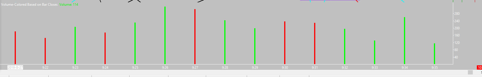

Only after I pressed the insert button to manually recalculate, both charts showed the same (and supposedly correct) volumes for the time after 09:25, too. I attached the two associated screenshots "...AFTER recalculation" to the next message.

imageCLEV19 1 min numbers bars chart BEFORE recalculation.jpg / V - Attached On 2019-08-27 07:48:47 UTC - Size: 22.34 KB - 511 views
imageCLEV19 1 min candlestick chart BEFORE recalculation.jpg / V - Attached On 2019-08-27 07:49:15 UTC - Size: 24.23 KB - 417 views

Here, I attached the remaining 2 screenshots ("...AFTER recalculation".
Thank you in advance for any advice on how to cope with this problem.
Kind regards
imageCLEV19 1 min numbers bars chart AFTER recalculation.jpg / V - Attached On 2019-08-27 08:01:17 UTC - Size: 23.7 KB - 400 views
imageCLEV19 1 min candlestick chart AFTER recalculation.jpg / V - Attached On 2019-08-27 08:01:25 UTC - Size: 27.88 KB - 440 views
