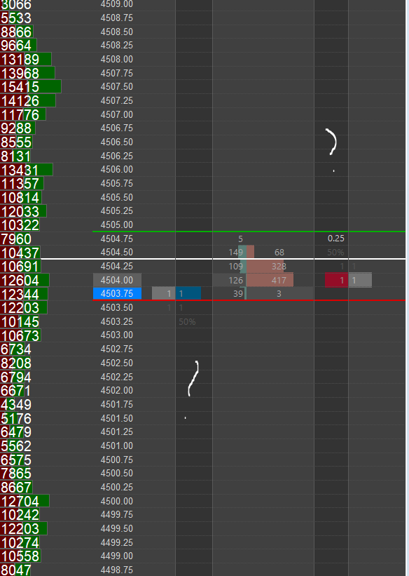

I am trying to replay the DOM, I have followed the instructions in https://www.sierrachart.com/index.php?page=doc/ReplayChart.html#ReplayingTradeDOM. It is working... However, nothing like it would in real time. 1) there's no level 3 data. 2) The bid and ask are showing at every other price. I am attaching two photos, one of what I'm seeing the other of is real-time (what I'm expecting.) Please let me know if this is working as designed.

[2019-08-08 16:25:20]
This is not by design. We had another report of this same thing, but we have not been able to figure out why it happens, as we have not been able to reproduce it.
Can you please let us know exactly what parameters you are using for the replay (or attach an image of the replay window).

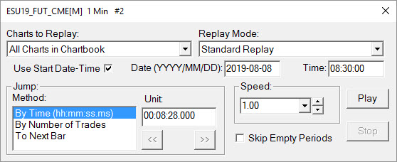

1) The replay settings - Please note, the "Skip Empty Periods" box isn't checked. I have tested both with this box populated and un-populated, both yield the same results.

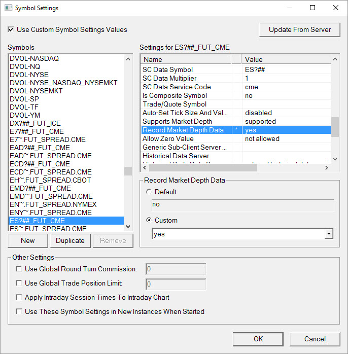

2) Symbol Setting - This shows I have the Record Market Depth Data set to yes. Also the "Use Custom Symbol settings" is also populated.

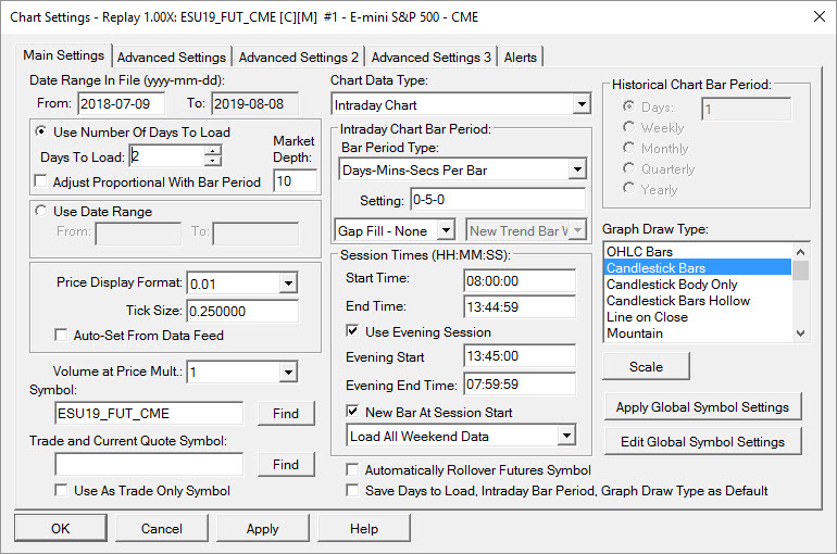

3) Chart Settings - Not sure if you need this one or not. Please note, I also have a 1min bar chart open and T&S. The following values have been linked to both the DOM 1min chart: "Symbol", "Session Times" and "Days to Load". With regards to the T&S, it is attached to the DOM. I have tested without the 1min chart, which yields the same results.

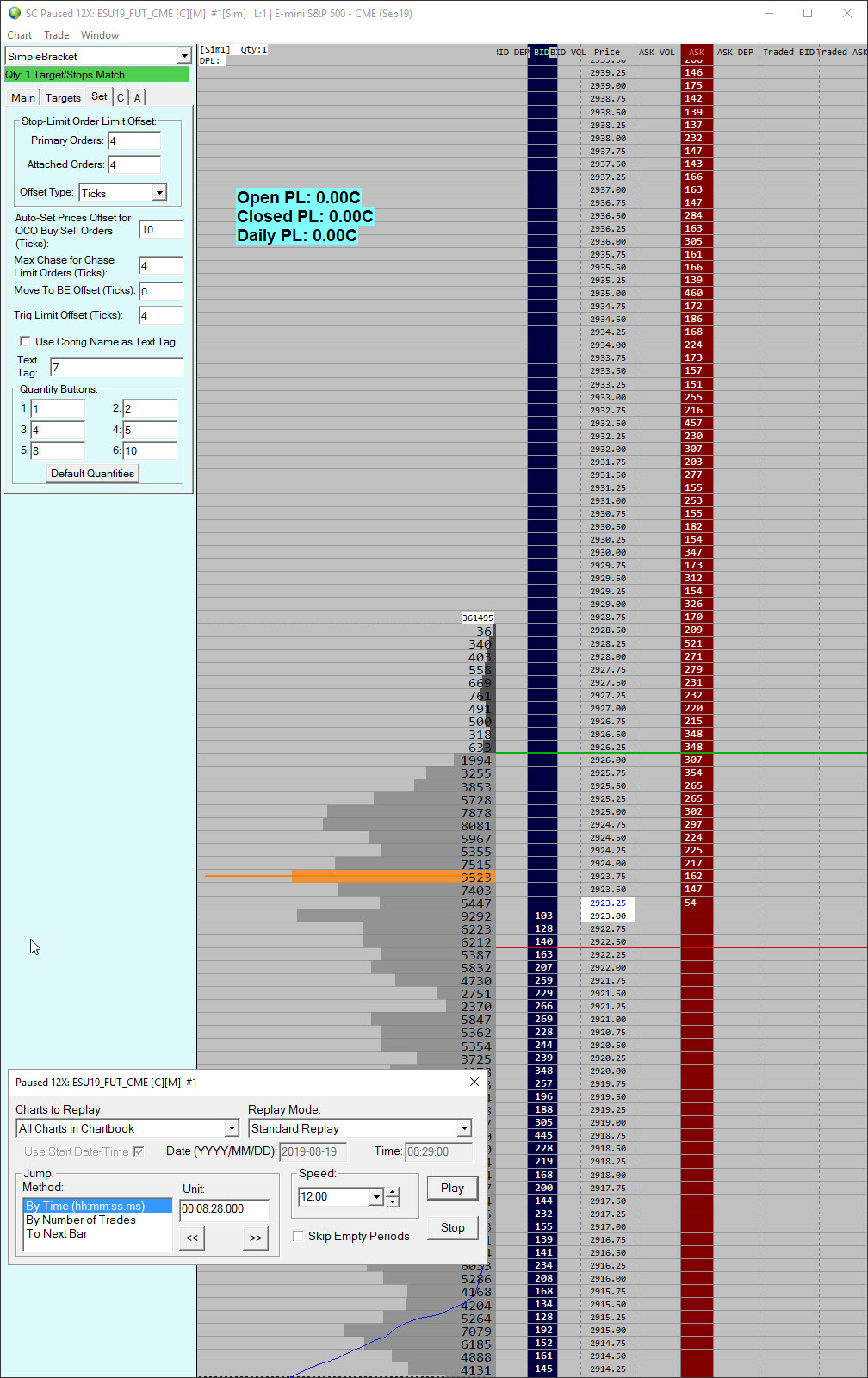

I have loaded prerelease (1976) version. The bid/ask looks to be correct. However, I'm still not seeing market depth. In addition, I'm not seeing any ask and bid traded volume.

[2019-08-19 20:29:04]
Why do you say you are not seeing market depth data? The blue and red columns clearly do show market depth quantity numbers.
[2019-08-19 20:41:58]
We will solve this.

[2019-08-23 21:30:47]
rxtrading - Posts: 33
Hello, I just loaded 1978 and tested the DOM. Everything looks to be working correctly. Thanks for correcting this issue!
